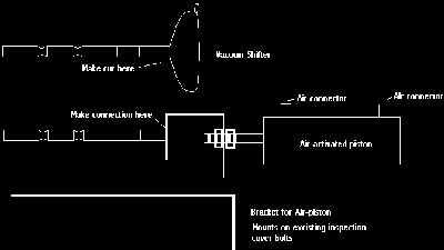

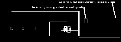

QT Air Shifting ModificationContributed By: Frank Almaas
What can't be seen on the drawings is that I made the engaging dents in the shift rod larger to make the hold better, did some grinding on the shift fork to make a more positive spline engagement inside the transfer (don't know if that works on a non part-time QT) and re-designed the light-switch to only light when the transfer REALLY were 4WD (Having ruined a couple of couplers on half-engaged 4WD)
