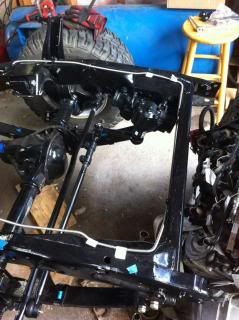

Yes, that is a shiny black frame with the tie rods in place, the Dana 44 bolted on the re-finished springs (loosely - explanation later), new disc brakes on the newly re-built hubs, the new SS brake lines loosely fit in place and a new power steering gear box for a S10 bolted to the frame.

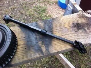

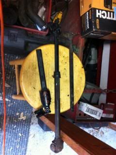

I also read that I could get rid of the rag joint with a mid-90's steering rod from a XJ. Well look what I found for $35
[IMG]http://www.ifsja.org/forums/vb/[/IMG]
This is the new steering rod mated to the Road Trip's old steering rod and painted. I know it's a little Prissy, but what the heck.

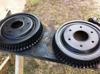

I was going to buy some new rear drums, but I had 4 old ones and all of them looked in pretty good shape on the inside. I couldn't see where they had ever been turned. So I took them all to the local NAPA that has been around since, well it used to be a blacksmith shop I think. Anyway, they turned all 4 for $8 each and the good news was that none had ever been turned and only one had the tell tale "whoop, whoop" as they started turning it and it was back round in seconds. So 4 good drums.
Yes, I painted the outside with brake caliper black. However, I was wondering if/how you paint the inside? NO, not the braking surface, but where the drum hits the axle. I can't decide whether to paint it or just cover it with anti-seize. What would you do?

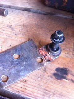

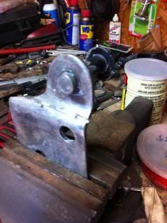

Remember I said the front axle was bolted loosely to the springs, well I wanted to use the old front steering stabilizer from the 79, but it was for the Quadratrac rider's side drop, and I'm going with the 82 driver's side drop, so out with the cutting wheel
And then I broke out the Lincoln stick welder
and the shock bolt is now in the right position for the driver's drop. NO that is not body putty, that is just the lighting from the picture, it is really just steel that has been ground smooth. My welding isn't pretty, but so far it holds, so I'm pretty good with a grinder. I'll be painting it next weekend and hopefully installing it.
