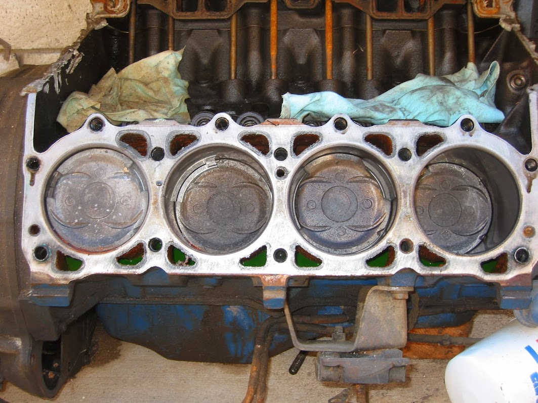

Posts: 9,956
This is probably similar to what you're going to see...
A fresh rebuilt 360 that PO obviously had some detonation issues.
