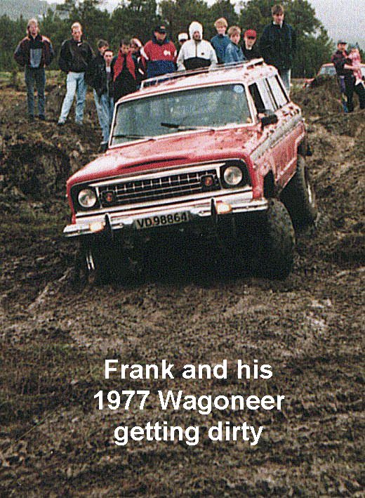

...a picture off my rig taken during one off last summer's weekend tours.
My rig is a 1977 Wagoneer with a rebuilt 360 bored .030 over and balanced
with ported heads, Edelbrock Performer manifold, PAW  camshaft, 9:1 comp,
Holley 600 vacuum carb, BlackJack headers and a custom buildt 2 1/2" double
exhaust. It makes around 320hp+. I get around 13 mpg with good luck!
It's lifted with a 4" Trailmaster kit and 3" body lift and runs 33x12,50x15
on 15x10 rims. I plan to install 36x12,50x15 Swampers. It wasn't done on
the picture but I also cut out the rear fenders 2" to have room for the
tires.
The rest of the drivetrain are TH400 rebuilt with a B&M Transkit, Q-Trac
with a MileMarker part-time kit, Dana 44 with 3,73 and Lock-Rights.
Everything is rebuilt.
I converted the AC compressor to an on-board air supply with an air-tank
from a tow truck. I also converted the vacuum activator for the 4wheel
drive on the Q-trac to run on air rather than vacuum (It failed all the
time and the Q-tracs are rare in this country)
