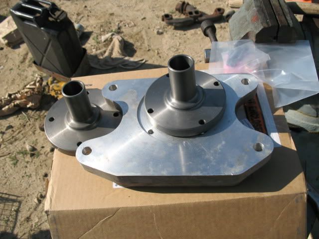

My adapter came this morning, but it isn't going to be plug and play. Partially my fault part Advanced's.
Originally Posted by Advanced Adapters website
With our adapter plates, we utilize a new front bearing retainer to obtain proper bell housing alignment. Chevy adapter plates we use a small index of 4.686”, (the larger index retainer, P/N 716051, can be substituted for the 5.125” bell housing) at no charge. The retainer must be exchanged at time of order to receive as no charge!!!
716051 doesn't fit .
The adapter itself is indexed for the smaller retainer (the one on the top of the adapter), and the larger one (on the box) will not fit the adapter.
The other issue results from me assuming that since jeep used a t-15 bell on the t-18 that the pattern would be the same. Almost, but not quite.
Here's the stock jeep adapter-
And here is the AA adapter sitting on top-
The bosses for the holes I need are there but no holes. I'm going to play with the jeep adapter tonight and see if I can (or want to) drill it. As for the bearing retainer, I'll take it in and see if I can get someone to cut an index for the adapter cheap or I'll go to the junkyard and pull an earlier chevy bell.

Well I solved one issue. I drilled the bosses in the jeep adapter. I just have to go pick up some allen head bolts.

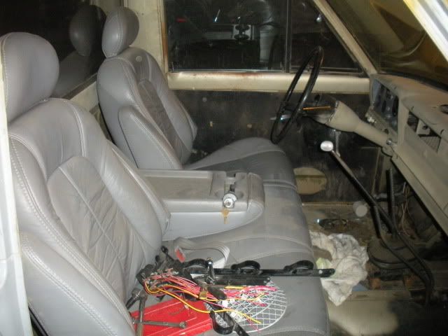

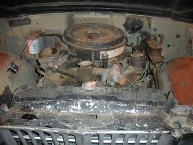

Well after getting re-motivated I figured its time to post a quick update.
I've still got a ton of work to do but it actually looks like a truck (most of one at least). If I would get off my behind and put some radiator hoses and a few wires on I could run the engine. And then I could bolt the rear driveshaft in and take it's first test drive.
Here is how it sits now.
More engine
http://i241.photobucket.com/albums/f...l/DSCN3528.jpg
http://i241.photobucket.com/albums/f...l/DSCN3527.jpg
gauge panel (with diesel tach)
Astro seat
