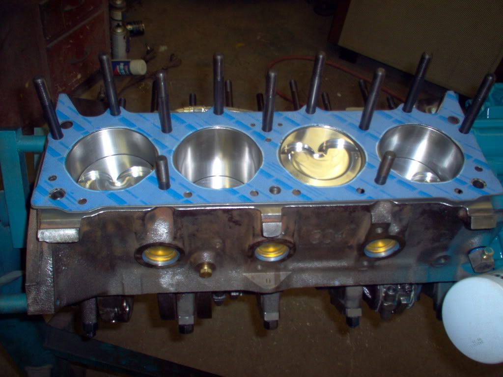

I take it these are 304 heads with the oversize valves. The Chevy valves clear the cylinder bores? My BOTEC says that they will collide with the 304 bore - maybe they clear if you're 80 over? Could you have relieved the cylinders and used 360 heads instead?
<read your description again - so these are 360 heads with undersized valves? What's the advantage of these heads over the 304 heads with the same SBC valves?>

The 1.94/1.50 valves clear the overbore. On a stock bore, the exhaust valve has to be cut down to a 1.45” to clear the bore … the exhaust valves are closer to the bore wall, than the intakes are. ON the 0.080” overbore, I could have run a 2.02” intake valve, but not a 1.60” exhaust valve … the exhaust would have needed the bore relief notch. Also, the 2.02” intake would have reduced port velocity, decreasing torque and MPGs.
The 1.94/1.50 combo WITH THE UNDERCUT VALVE STEMS, is an excellent upgrade over the stock AMC 1.787”/1.406” valve sizes. With the smaller valve stem diameters (5/16” in the runners due to undercut) they flow about 40% more at lower RPMs, which decreases as RPMs increase (negligible difference at 5,000 RPM). This added flow at low-mid RPMs makes a HUGE difference in torque, power and MPGs.
I did the 1.94/1.45 combo on the head for my ’83 Spirit GT (258 4-speed) and it was night and day. It made the stock 258 perform and feel like a 4.0L HO was under the hood. I would estimate I picked up about 30 HP and at least that much torque, just with the SBC valve swap.
These heads are AMC R&D 360 heads. They had 1.787” intake valves and 1.68” exhaust valves installed, and a swirl-port design. AMC was testing them out to see how emissions and MPGs could be improved with a lean-burn swirl-port design. I had hardened valve seats installed on the exhaust side, so that the smaller 1.50 diameter valve head could be used.
You can also do the 1.94/1.50 swap on the 304 heads. FYI, a 1.94/1.60 swap on the 304 heads is really good for a street/trail 360. Low-Mid RPM torque and MPGs is increased, due to the higher port velocity with the smaller 1.94 valve (as compared to the 2.02 360/401 intake valve).

We also checked the difference between the OEM timing cover from my 360 (circa 1995 manufacture by Mopar) and the new aftermarket Crown cover. The Crown cover still has the distributor fitment issues, which requires some massaging of the cover to get a distributor to fully seat properly and mesh with the cam gear. I'll get pics of that up later. I'm going to run the OEM cover since it is in such good shape ... and my cam/dist. gears will appreciate the better fitment of OEM.
Also, I have pics of the ROL Xtreme 360-401 head gasket vs. the Felpro HiperBlue 304 gasket. I'm going with the 304, since it better fits the bore diameter. I'll end up with aboug 10.2:1 compression with it, as opposed to 9.95:1 with the ROL gasket.
