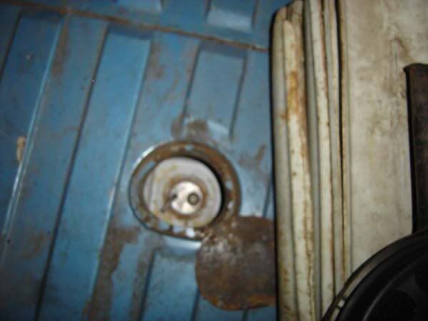

In case anyone is curious what it looks like...
There was about two inches of dirt in the top. I shop vac'd it out and cleaned the terminals - my fuel gauge started to work a little bit (but not correctly) - it moved from the bottom of the E to the top of the E on a full tank. I even put some dielectric grease in there. Must be a bad sending unit. Is it possible to get the sending unit out without dropping the tank?
While I was in there, I checked the black wire, and it was perfectly grounded. I grounded the pink wire and my fuel gauge pegged fuel. So I know the wiring and gauge are good.
Yep. It's almost like Jeep engineers were actually THINKING!

Easy to remove. I just replaced mine. See http://www.ifsja.org/forums/vb/showthread.php?t=81793
Just disconnect both fuel lines, both wires, and remove the large nut. It's plastic so it shouldn't take to much effort.
