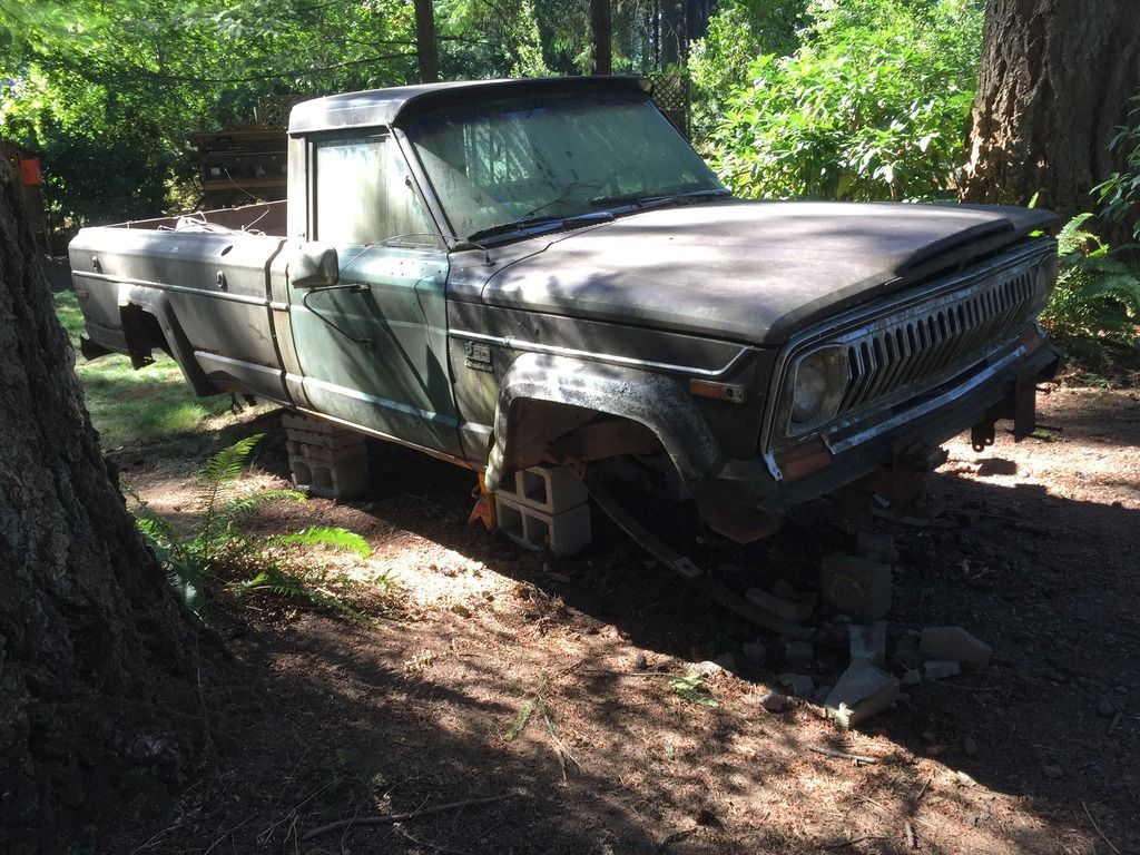

Rolled in the 1965 Jeep J300-down but not out:
[IMG]http://www.ifsja.org/forums/vb/[/IMG]

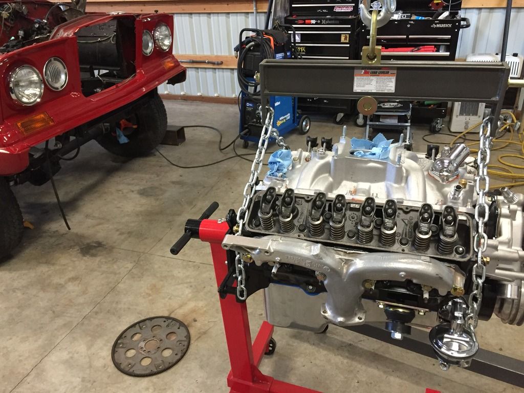

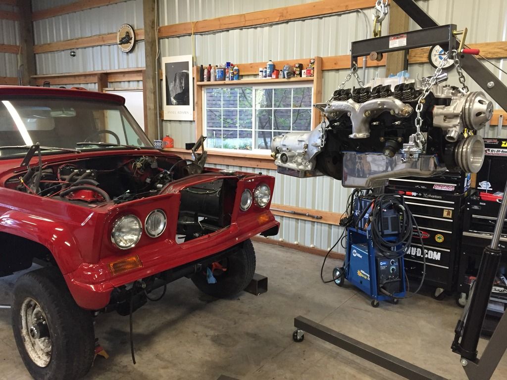

Out with the old 383:

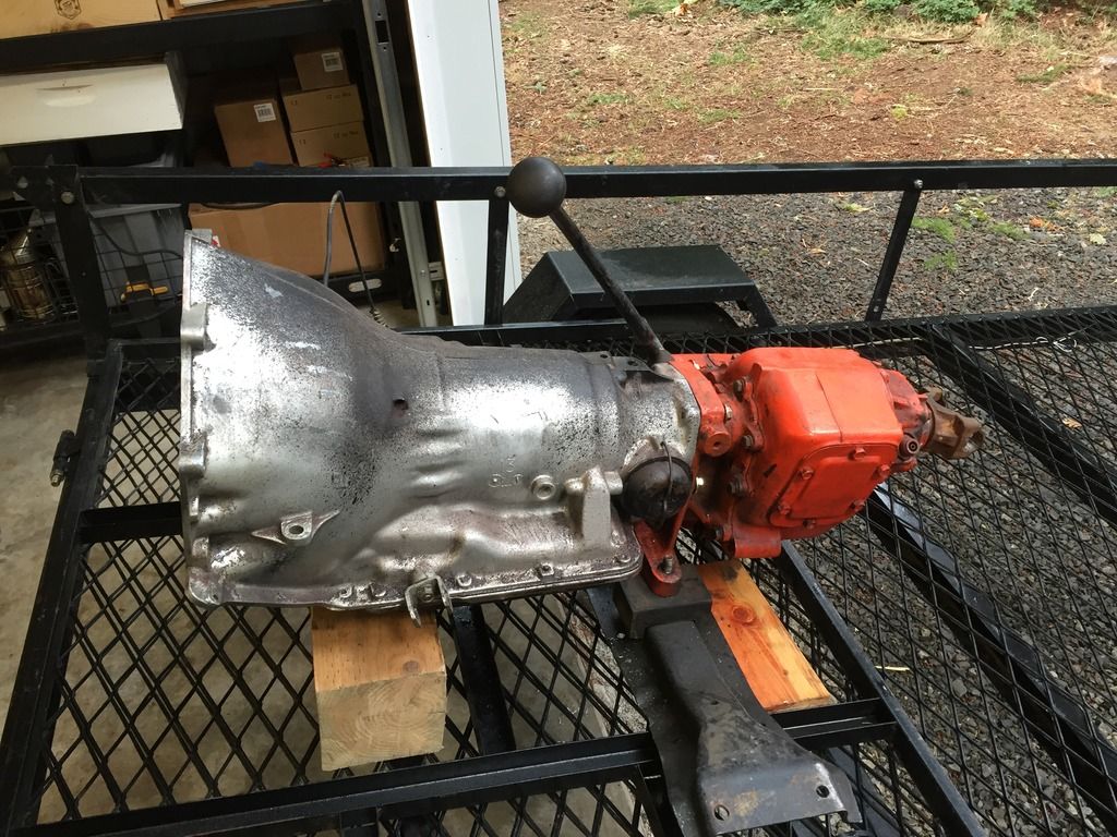

Pulled the TH350 to get rebuilt and found a NP205 for $100. Had the shop replace the seals and check it out:

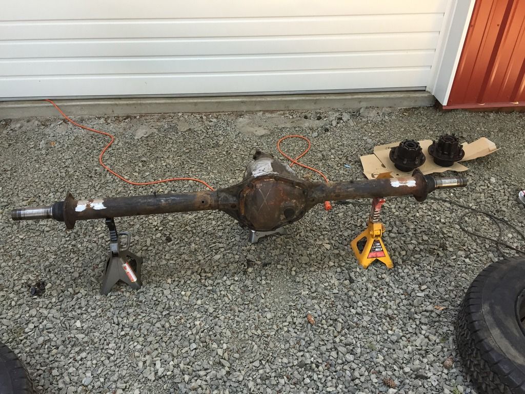

Ripped out the old axles and went crazy cleaning and sealing undercarriage/frame:

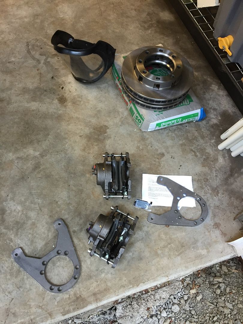

Besides rebuilding the J20 axles, they're getting disks at all 4 (+ hydro boost that I'm finishing up now), moly axles and Spartan lockers:

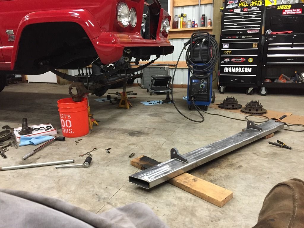

Started on the rear bumper:

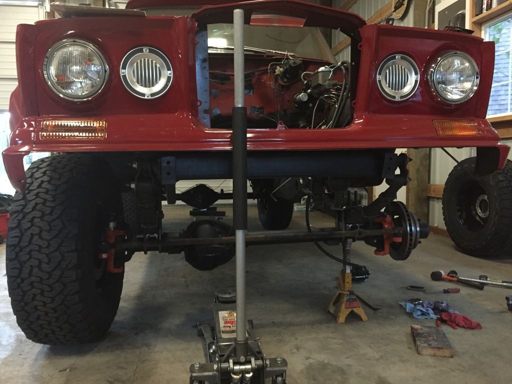

Swung the axles back under and adding some beef (Reid, all new timkin all around, 1 ton steering, HD perches, etc.):

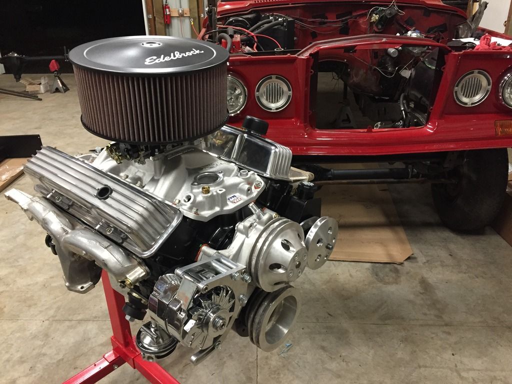

Putting together the GM 350/290 motor (will be changing cams later but its a good cost effective motor):

Had to offset the front Dana 44 due to the Expletive Deleted!Expletive Deleted!Expletive Deleted!Expletive Deleted!ed casting but a .25" wheel spacer will fix that:

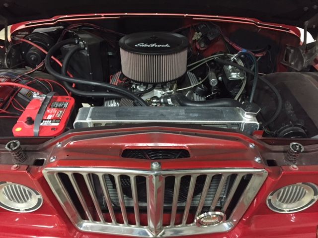

Where we are today...
Got some more welding of the shock towers done (RuffStuff loves me these days):
I feel guilty for how clean stuff is looking these days (lots of aluminum):
Didnt really want to go with a "pusher" but it is what it is:

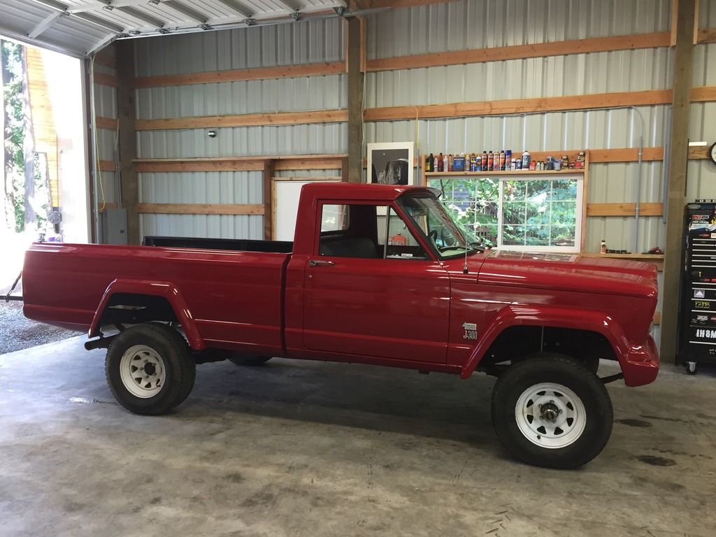

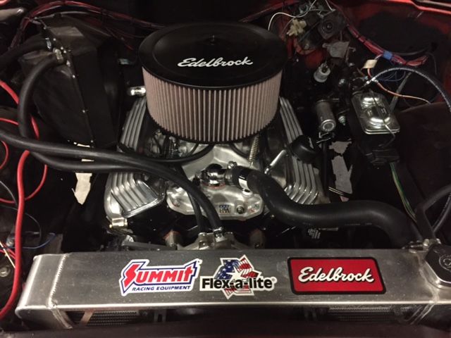

Finally getting things stuffed under the hood and topping off fluids:
Next up is finish the hydraulic/brake lines (all new as well), set pinion angles/weld up perches, get drive lines measured and cut, install the NOS Warn front bumper, rewire and turn the key.
1965 Kaiser/Jeep Gladiator J300 7600 GVW

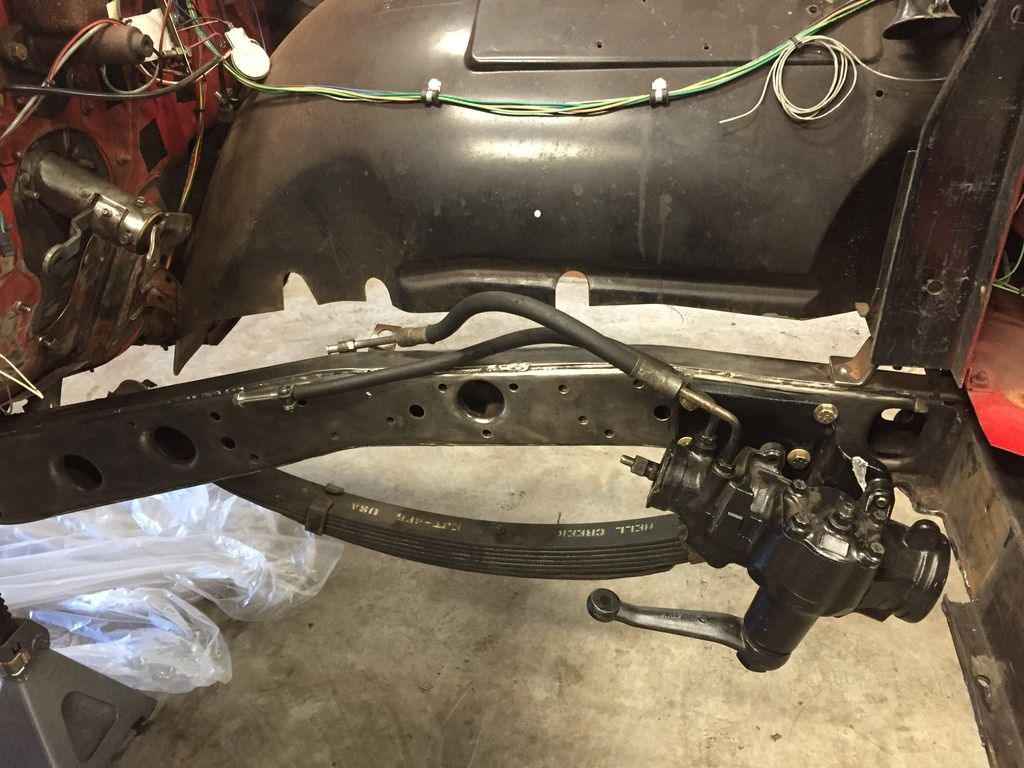

Finally figured out the hydroboost lines (had to get custom made but after visiting more than 8 shops I finally got fed up and bit the bullet). Also added new AT lines (Advanced Adapters SS lines), belts, hoses, etc. Most important thing was putting the "horn" back on the rhino!

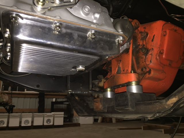

Figured out the new transmission mounts using some 1" aluminum body mount spacers. Finally settled on a 3* camber for the motor/tranny. Now to get the axle angles dialed in, welded, and measure for drivelines...

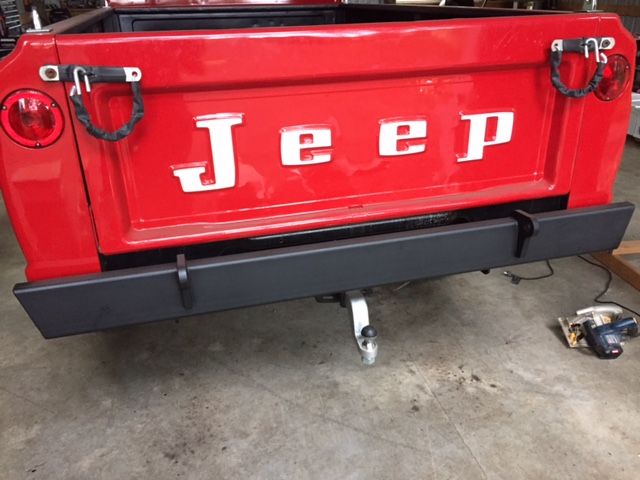

Rear bumper and 15,000# "weld in" tow hitch are finally finished. Lord help the fool who rear ends me in this 'cause its 1/4" 2x6 steel. Hope it will also add some stiffness to the frame.

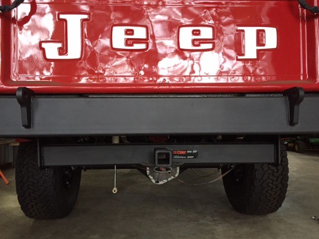

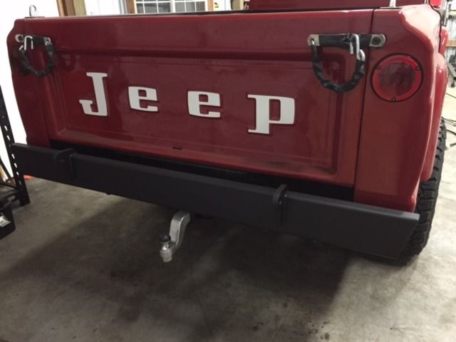

Old 01-25-2016, 07:54 PM
Kaiser's Avatar
Kaiser Kaiser is offline
Join Date: Jan 14, 2006
Location: Sandy, OR
Posts: 644
Originally Posted by tgomes1987
Can you post a picture of the rear bumper with the whole truck in view?
I like the look of it and may want to build a similar one.

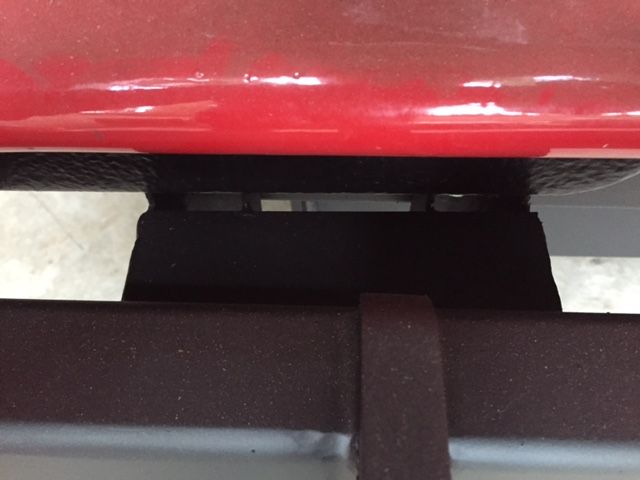

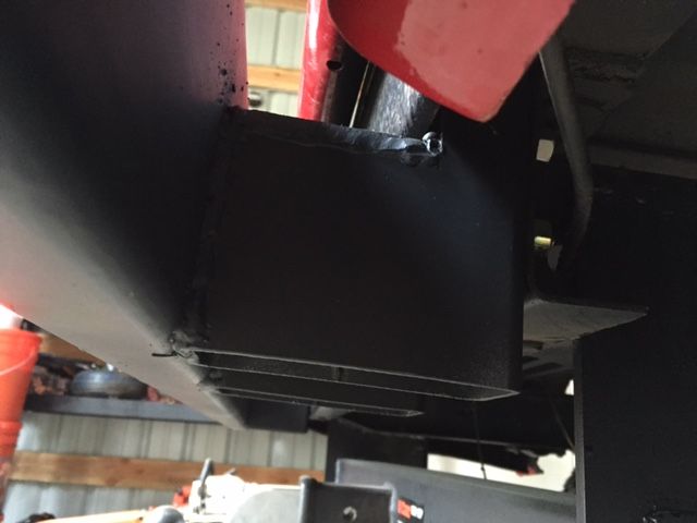

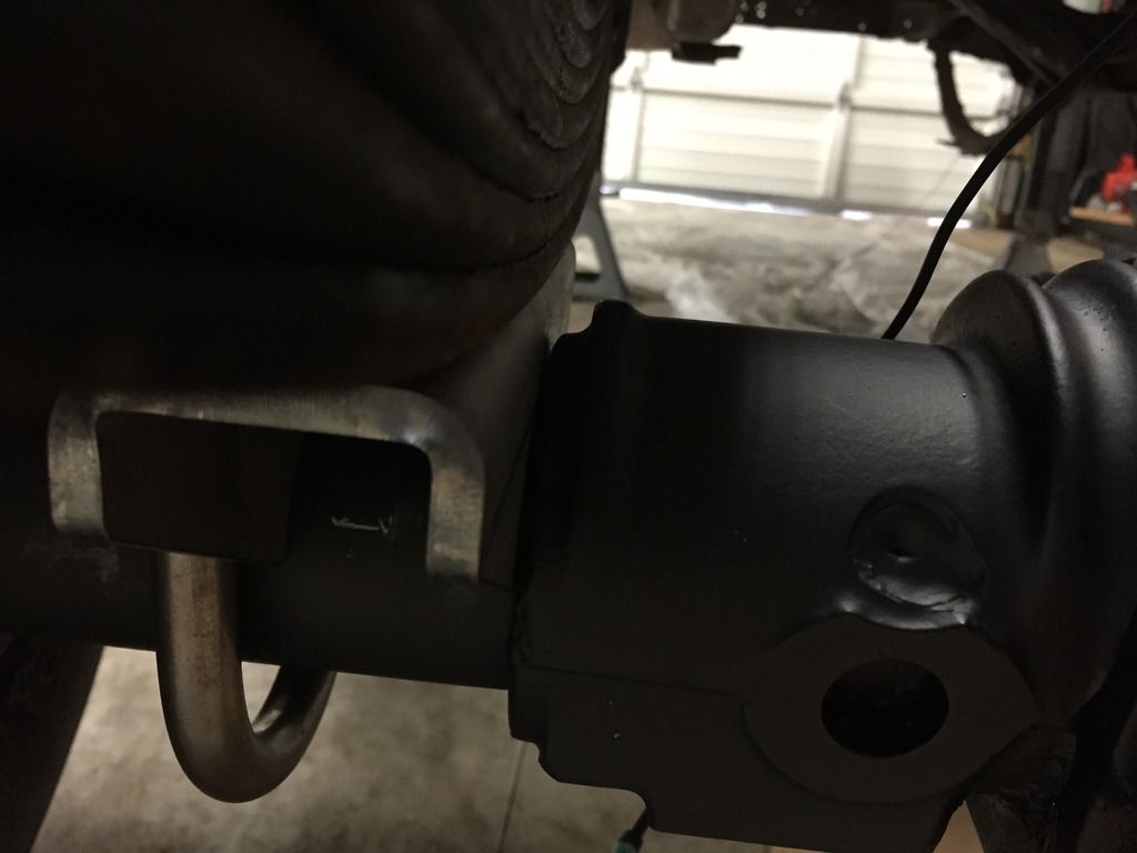

Some pics as requested. The mounts are from some 2x6 stock I had on hand (boxed in) and actually goes up between the body and bed panels allowing for four 1/2" grade 8 bolts on each side to mount to the frame.

Old 01-25-2016, 09:19 PM

Old 01-26-2016, 12:00 PM
tgomes1987 tgomes1987 is offline
Join Date: Nov 12, 2008
Location: Yuba City, CA
Posts: 58
Thanks for posting those. Looks good! I'm going to build a similar one
Old 01-26-2016, 03:48 PM
Kaiser's Avatar
Location: Sandy, OR
Posts: 644
Go for it. The 2x6 notched worked really well and could be done with just a grinder and welder. Box it in on top and inside but leave the bottom open so it wont collect junk/rot. Using .25" it had to weigh at least 70# and added some extra protection that was desperately needed. Make sure to take measurements so to ensure the bed gate doesnt hit when down.

Old 01-27-2016, 10:38 AM
Posts: 58
Got it thanks! Looks simple and effective. Just how it should be
