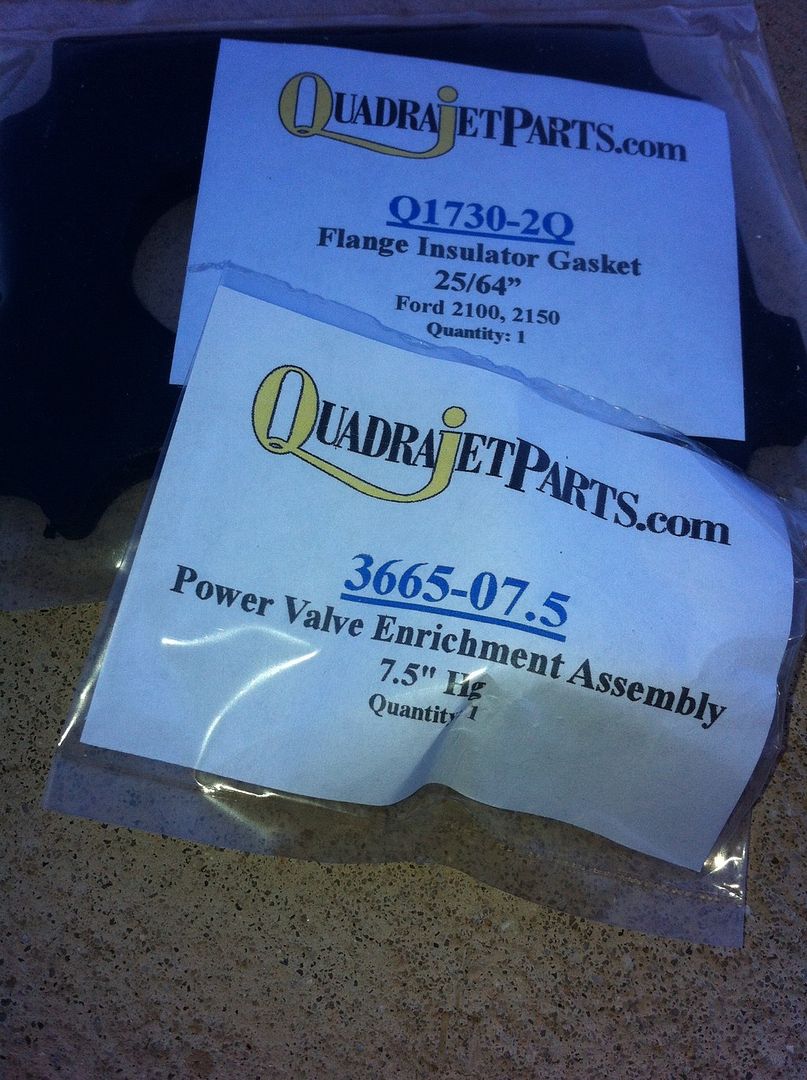

A major tune-up came shortly, but during that phase of trying to get her to run better, I started doing other stuff to at least help her cosmetics.

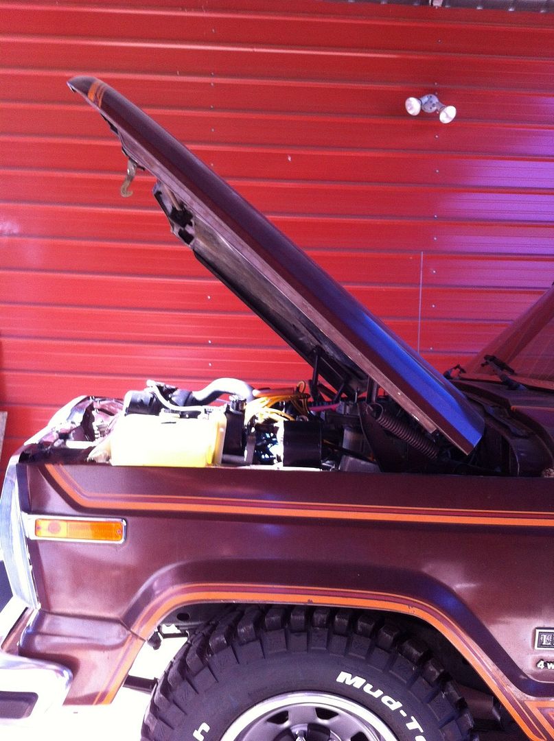

After a bit of spitting and farting and mechanic friend yelling at her, she finally started and moved after quite a few months of sitting while the engine was being done.

This weekend the Power Valve Enrichment assembly will be going into Crusty. I'm saying a prayer that she goes ZOOM ZOOM after it's installed!
Right now she only zooms coughs farts and zooms again. She did make it to 70mph last weekend, but don't want her backfire to blow off my new muffler!

I'm getting tired of the hood being open on Crusty!
New power valve in carb helped a lot but we are going to give her bigger jets as she still seems a bit thirsty. Got her up to 75mph and she didn't loose as much power going up the hills, but still backfired twice. Such a fussy, fussy beastly girl. Hate to spend $$$400 on a new carb, but hoping slightly bigger jets does the trick, and the hood can remained closed for awhile!
She did get a compliment at the gas station tho. Awww. A classic crusty!
