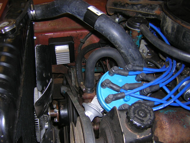

Also, I'm running the "stealth HEI" on my CJ-6 -
- the HEI module is in the black project box and heat sink on the fender. Works well. This Jeep was originally equipped with the problematic Prestolite ignition.
