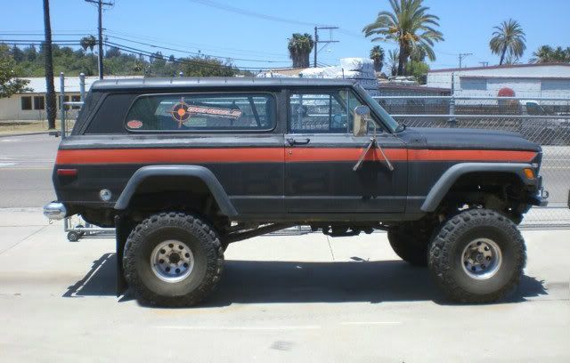

Thanks Eric for putting the time and effort into the Photoshop lift here. It always amazes me what you can do with a computer! I wanted to get these pics up for you guys to check out. Eric did a great job adding another 4 inches on this and it really gives me a gimps into the future if I decide to go bigger. I should of given him a pic with out the fence line in the back ground. It makes the rig look the same height in both pic's. Im liking it and already getting use to the idea. Its really hard to get a feel for the height with nothing to compare to. Well whatcha think, Yea or Nea? Pro's or Con's?

Looks good, I say go for it.
Had to stare at it for a minute because that background sure does play tricks. If I had my comp I'd change the background for ya with a blank shot in my field where I always take pics of my cars, but I'm going to be out of town for a few days and only took the iPad.

Yeah the more I look at it it looks in proportion. It really doesn't look much different to me but guessing the pooch might need a ramp now that she is starting to slow down. Maybe a fold down ramp off the tailgate or something. Heck I might need the ramp! Thanks again Eric, great work.

This is the only profile shot I have. I'd like to get some lift springs on there, but not in the cards yet. No rubbing though
Perfection. Proportions are just right! No need to make it sky high. Just enough to clear the tires at full stuff. Makes for a better driving stable rig.

So this weekend I threw the 38's on without the additional lift. It will be ok to drive around town on but its not wheel-able. I think the additional 4 inches in the lift will be required to actually use the 4x4.

Yeah its growing on me as well... Literally! Thinking I will loose two spring out of the front pack and see if that is too stiff for wheeling or not. Plus it will level out the ride stance. Right now the Burb is nose high and I really dont want that on the FSJ.
Bumpstop/trim it more and run it as it is. Another 4 inches and that things going to be way tippy. Low and stable is where its at!

Well I had the lift springs so I had to at least see what it would look like fully lifted... 38'" Swampers and a 10 inch lift.

38" swampers and a 10" lift now you need bigger tires

Yes, bigger tires! That thing looks awesome How does it drive?

The thing drives OK except the drive shaft needs to be lengthened. It is stupid tall! 68 inches from the peak of the hood to the ground. I'm going to loose 2 leafs from the front to loosen it up a bit and bring the front height down level with the back.
