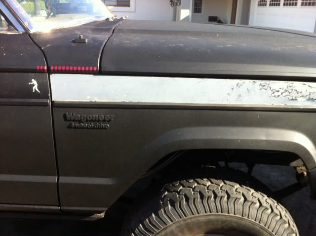

In all seriousness, my tent heater made ALL the difference. I set it up on both a cooler and a garbage can to reach different levels, let it bake the woodgrain for a minute or too, and the stuff peeled right off. In sheets. No damage to the paint underneath.
The side pic below of the passenger side of the rig was just about a total of 1 hour of work.

I just did this yesterday (front fender) in about 30 minutes with a razor blade scrapper ... the grey is the factory primer ... I will be happy if the rest of the rig goes that easy.
