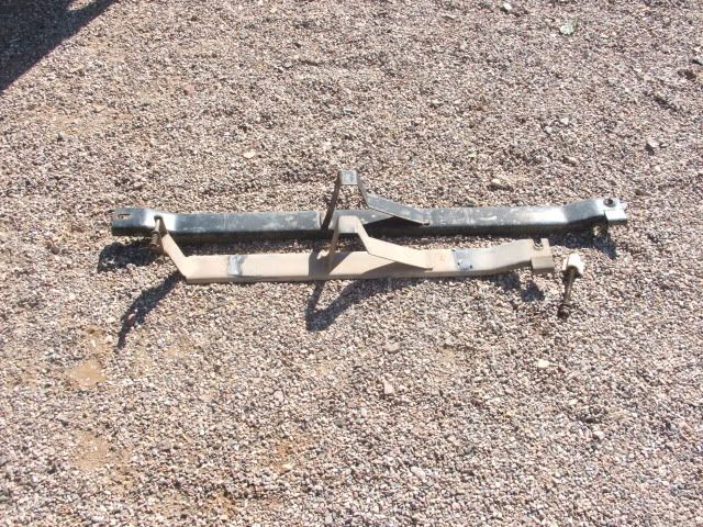

Does anyone know if the under frame carrier from a Wag/Chero will fit a Jtruck? I figured they may be different since the frame width is different in the back. I have 3 Jtrucks sitting here but none of them have factory carriers on them.

I don't think they will fit a J truck. The ones for the trucks went across the frame at an angle and are much longer than the ones on Wag/Cheros. But thats not to say they couldn't be made to fit.

The J Truck tire carrier are about 4" longer.
I will see if I can get a picture of the two.

Did I say 4", how about 15" didderent. Oh, Flint put this with all the other pics you save. LOL

Thanks for the pic Jerry!

Wagoneer carriers are the same as 1971 and older Gladiators, you might be able to make them work on the 72+ Trucks by adding the bracket to the 2nd to last cross member.
