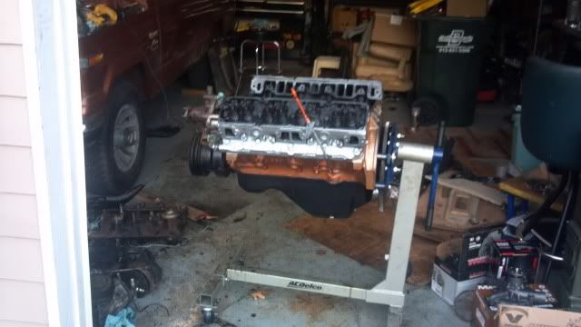

I have the motor out and on a stand and cleaned and prepped block for paint, took off all accesories. I pulled off the intake and the valley cover/intake gasket and there was so much black carbon like build up it was ridiculous, it was completely surrounding one of the pushrods. Ill post more pictures later tonight.

For some reason im having a hard time removing the gears from the housing for the oil pump. I got the gear out that doesnt have a shaft connected to it, but the one WITH the shaft on the gear does not want to come out, it will spin freely and will come out about a quarter inch and then not want to move. Next things are removing and capping most of the vacuum ports for the emissions delete and cleaning and painting all accessories. I have a new water pump i will install after i paint the timing cover. enough of me talking. here are some pictures.
Here is the engine right after I pulled it at about 10 P.M. on New Year's Eve.
After powerwashing and some elbow grease.
since I couldn't find any copper engine enamel, I used 3 coats of the rustoleum "hammered" copper metalic paint with a coat of clear duplicolor engine enamel after each coat.

I'm liking what I'm seeing. Planning to pull my motor for some similar work soon. I did an oil pan gasket last winter and I don't want to do all that work under there again. I'd rather yank the bolts and plop it on the stand.

Yeah that is pretty much what made me pull the motor, I previously replaced the oil pan gasket but it still was leaking due to lack of patience and not a lot of room to work. Plus it gave me a reason to spend some more money to make everything look nice
