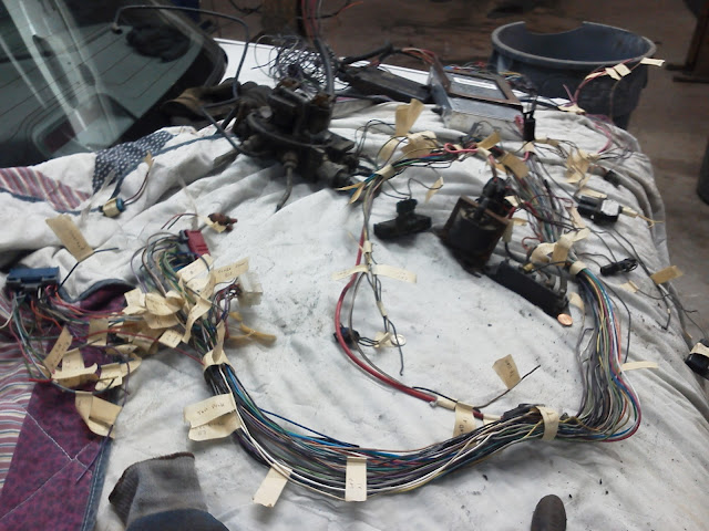

Bed has been done for some time now. Been jumping back and forth doing little things here and there. Almost done with my TBI swap.
Working on the harness
Made an adapter for the throttle body out of 1/4" aluminum
Got a little carried away welding the distributor
Got a stock tbi in tank pump on my shortened fuel sending unit. Drilled a hole in the top and ran it through a vacuum line(pulled it from my distributor since I dont need it anymore ) and I'll use black rtv to seal it up but it's a perfect fit.
And the O2 bung welded in
I dropped the reluctor roll pin when I pulled it out and it fell in the grass. Can't find it so there's nothing I can do about starting it until I figure out where to get one. But the harness is in and all the hard work is done so hopefully I can start it this week. Hopefully the pictures help some.
