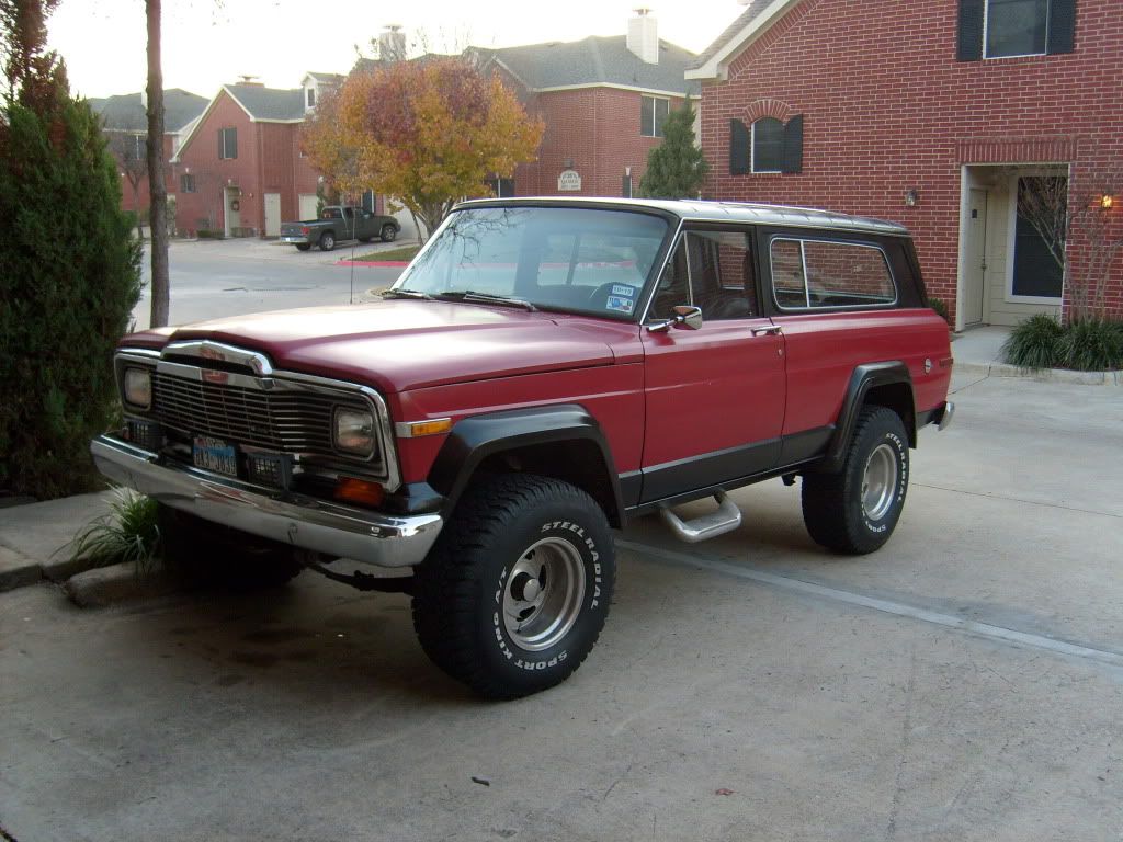

I originally bought the cherokee in the fall of '09 and started to plan the project. I wanted this truck to be my daily driver and weekend warrior with my boys. With the lack of ready availability of replacement parts, I decided to go with a modern driver train. I chose a 5.3Vortec with 4L60e automatic and 241T/C. This would call for custom driveshafts and fab'd shifter linkage. No real problem.
I wanted some comfortable highback buckets, 3series BMW's worked great with some fab'd seat brackets. A center console, reworked one from a Tahoe. A rhino swap, early 3pc bumpers (real chrome).
Body was blasted down to bare steel and all the holes/rust repaired. Then some sweet chromabase paint with satin black trim. Wheels and tires and I'm almost done. Still need for interior finishout, but I drive her every day!
And lastly, everyone loves pics, so here you go! Will try to post more pics as things get finished.
As I bought her
79 Cherokee, 5.3Vortec/4L60E/241TC, daily driver, not quite finished

The gauges are "normal" lighted gauges, so its just a matter of wiring them to come on with the headlight switch.
The side steps are LUND, for a 2door Tahoe 90s era, bought off Craigslist.
The seats (need to post a pic) are from a mid 90s BMW 318ci which is a covertible. They have to be from either a ragtop or a coupe so they fold forward for backseat access.
