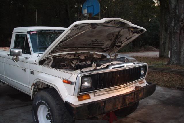

Well I have had a bunch of different Jeeps .I am in the process of restoring a 70 Jeepster commando .The other day I picked up a 67 J-2000 for my son and I to build for his first vehicle . The Plans are the relocate the front springs to under the frame, axles will be a semi float 14 bolt rear and a 44 front both 8 lug . I have already picked up the engine I will be using a 4.8 Chevy hooed to a TH400 and a Dana 20 T-case . here are some Pics .

Welcome! Question, why relocate the springs? The post mount springs make for a pretty good ride and give more stability off road.
The frame is pretty wide - with the springs outboard (stock location) the springs are wider than the drums on my 14-bolt that I'm putting in. In the front, the outboard springs limit turning radius a bit as well. With the stock closed knuckle its not much of a problem, because the closed knuckle already limits turning radius. If you swap that out, it's pretty easy to get the tires into the springs.

That makes sense. The drums on the 14 bolts are huge.
