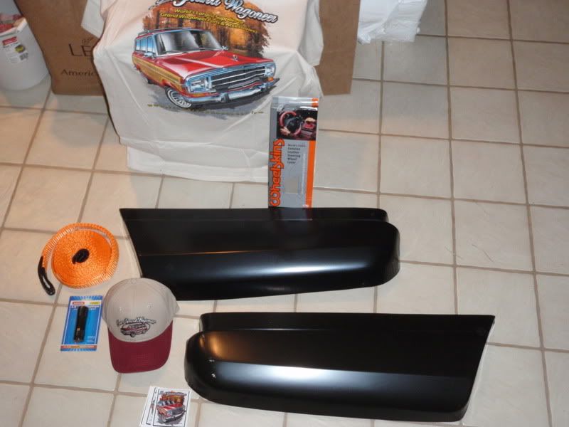

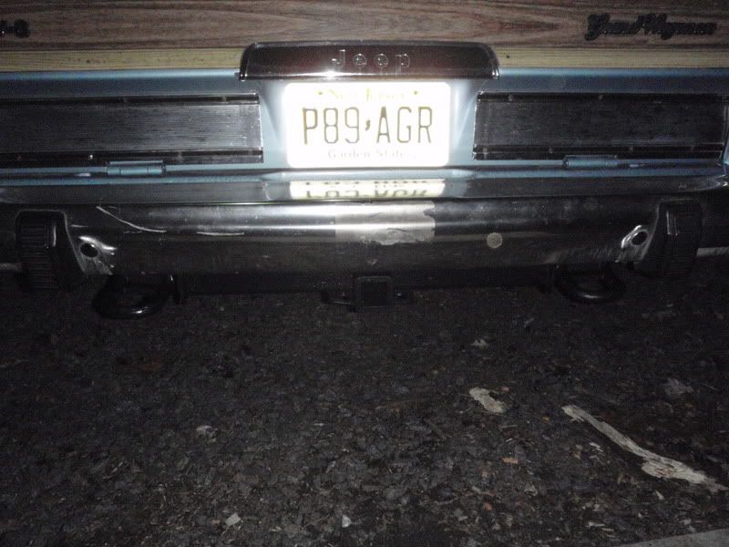

Well Monday after Black Friday (aka cyber Monday) I made an order to Team Grand Wagoneer for Lower rear quarter panels and a 10,000lb strap for emergencies only. Also got a leather warp kist for my steering wheel.

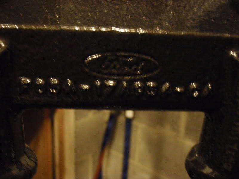

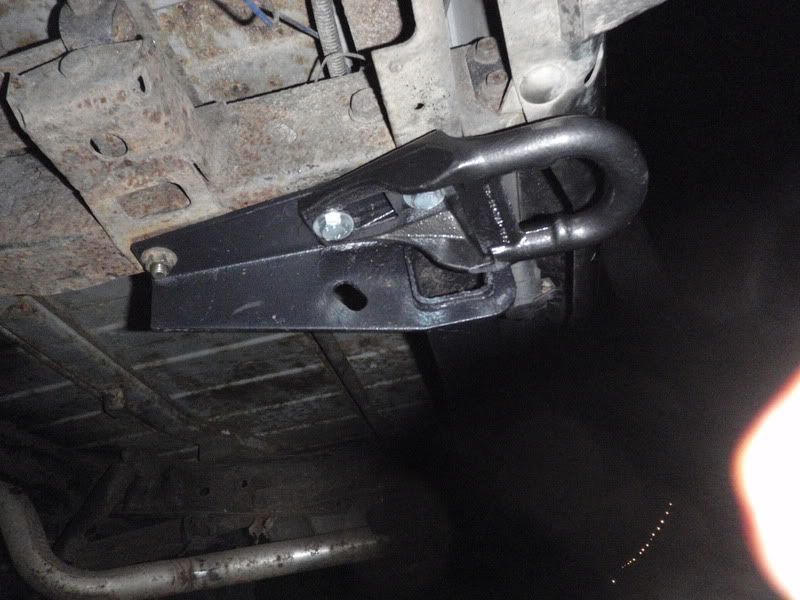

In prep for the Rausch trip i went to the Junk yard and got a rear hitch off of a Wagoneer and brushed the rust off and then painted it. while there i snagged tow hooks from an expedition front bumper and also mounted them to the rear. I can now be towed or tow from the rear. someday i'll mess with the front.
Used all grade 5 hardware for the towing parts and hitch is mounted using factory holes and the hooks are mounted through the frame as well.

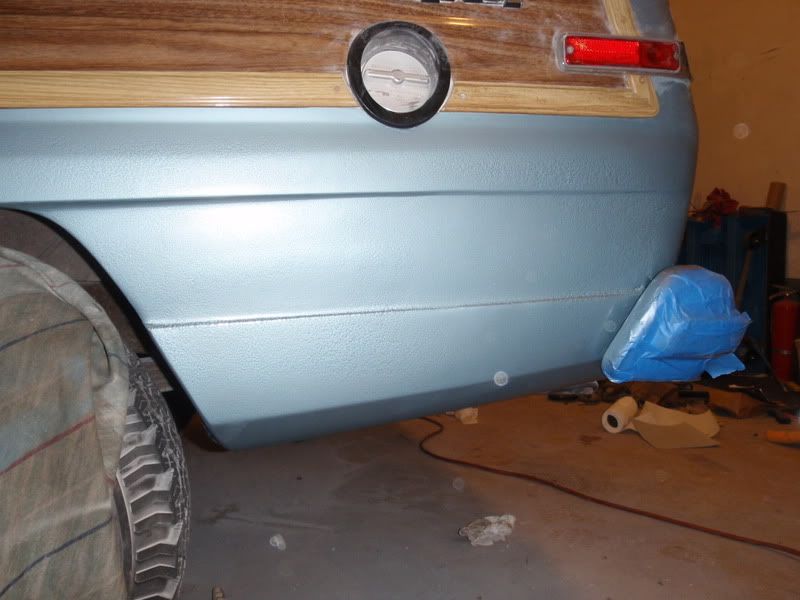

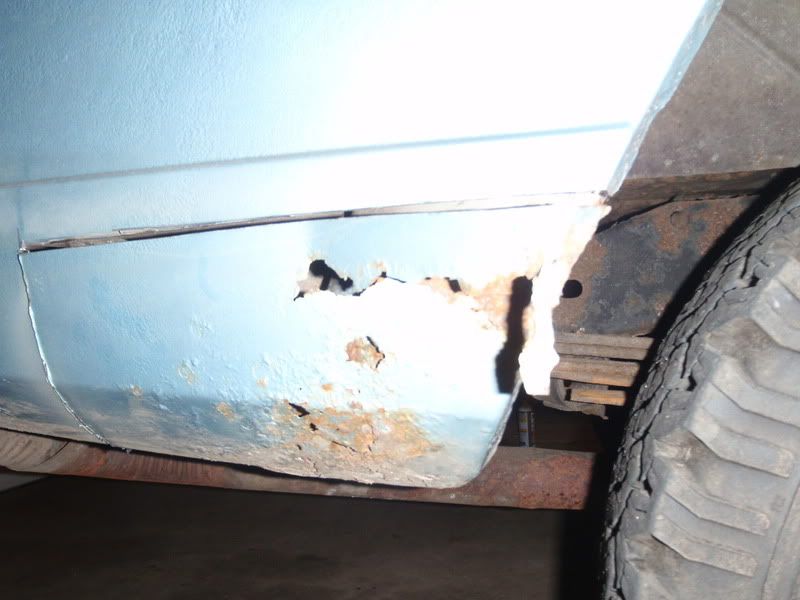

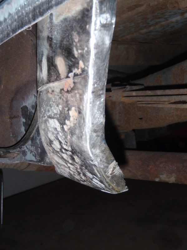

Now the last two days i finally got the ambition to fix the driver's side rust on the rear quarter. Also uncovered previous body work and made it look as good as i could sorry no close up before pics only one original before and afters.

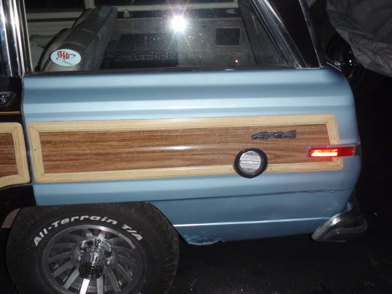

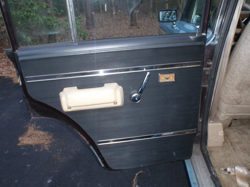

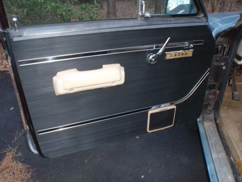

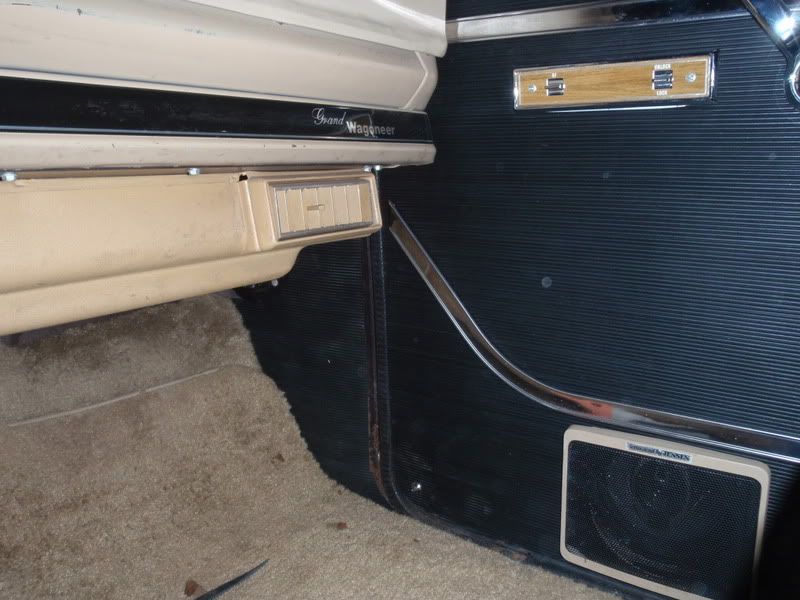

Well here are the new Door panels i made, used plywood and then Rubber Floot Mat material and contact cemented them together and voila. also installed a new front passenger kick panel as well. then made the rear driver's side cargo area panel and installed it. Here are the pics and hope you enjoy
[IMG][/IMG][IMG][/IMG][IMG][/IMG][IMG][/IMG]

i like the interior panels. simple yet functional.

Went with simple and cheap yet durable, next series will be made of ABS when funds allow so water will not be a problem

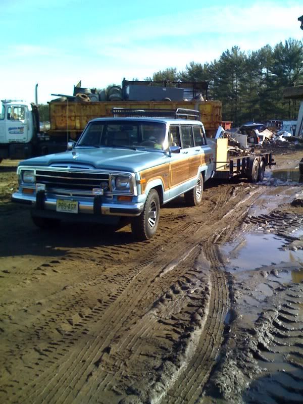

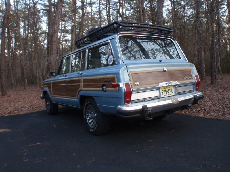

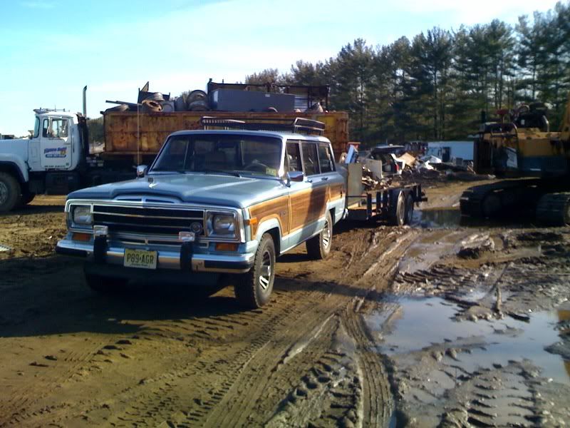

Jeep Earning it's Keep
Today the Jeep earned it's keep today towing a 20' flat bed with a thousand pounds of scrap on it. Brakes didn't seem too bad but man the rattles seemed worse and the sway wasn't too pleasant either. But still a good adventure with my first trailer tow in a personal vehicle.
And Pics cause you guys love them

Glenn the patch panel looks fantastic, well done. Interior is interesting. Never seen that before. kinda like a your own rubber room on wheels

I like that interior! can you post a link to the material that you are running? you mentioned that it is rubber floor mat material but is there a source that you wouldnt mind sharing?

The patch job looks great to me. Interior panels get a

The Material
Here's a link to the rubber material I used on the door panels.
http://www.sears.com/shc/s/p_10153_1...=1327158717263
But i bought it at the local hardware store. They sell it by the foot with either a 24" width or I believe 36" width. So at about $4 a foot each door panel cost me about $20 give or take

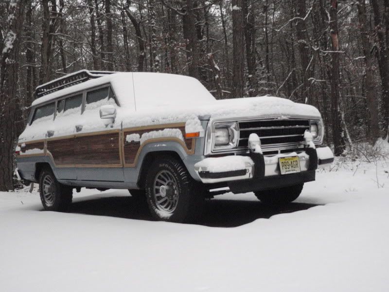

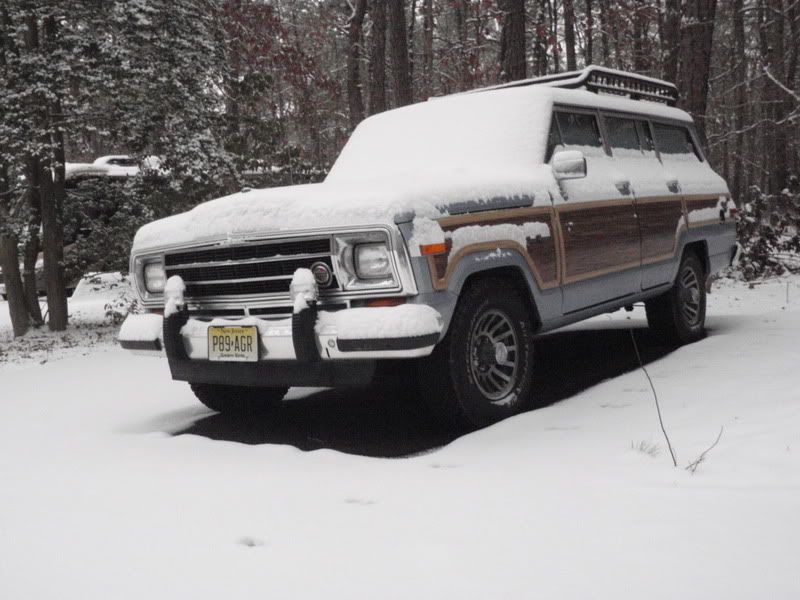

And Snow pics, Cause we all love pics

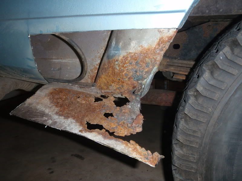

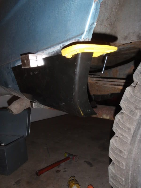

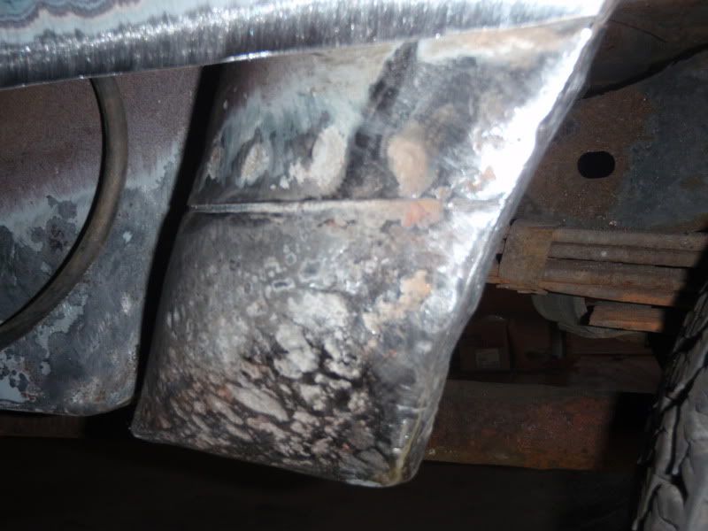

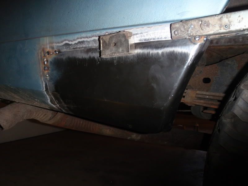

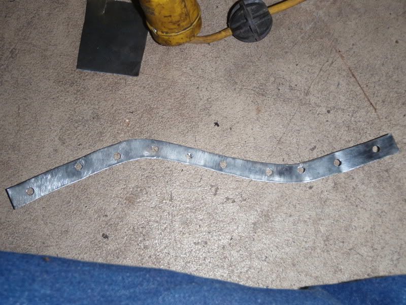

Finally Some work
Finally got the time/ambition to work on the Jeep today.

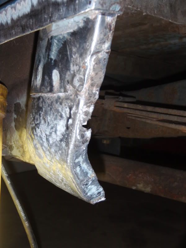

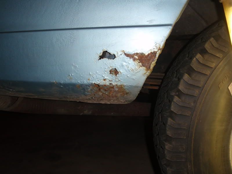

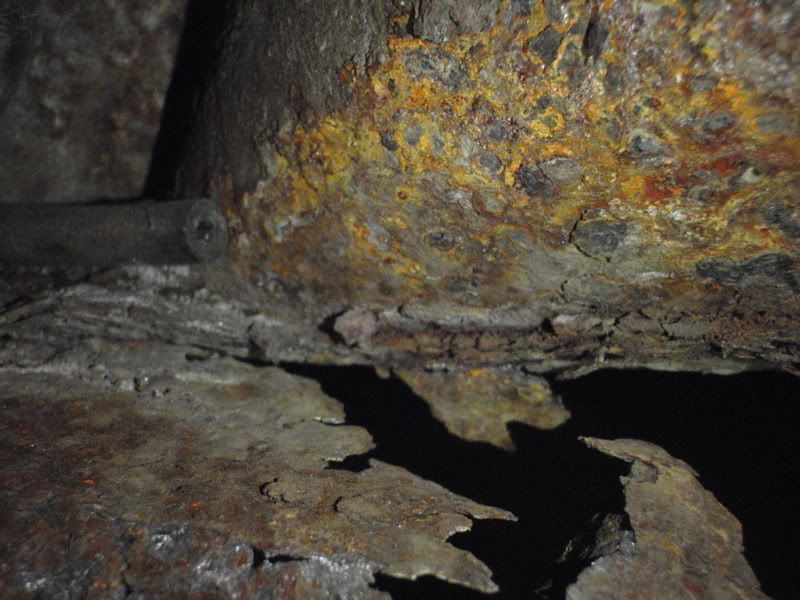

So I started fixing the rear passenger side Quarter, The rust isn't as extensive as the driver's side was so lucky me.
The Start
Could be Worse
Removal
The Damage
[IMG][/IMG]
The Fix
[IMG][/IMG]
Then
Ground the metal as smooth as possible, then treated with Naval Jelly to inhibit the rust, then sprayed with a rust treatment then heavily coated.
The Mockup
[IMG][/IMG]
My Crumy welding
[IMG][/IMG]
How it is now
Waiting for the Primer to dry then to body fill and sand smooth. I'm not the best metal worker so I try to get it as flat as possible and then fix with body Filler.
