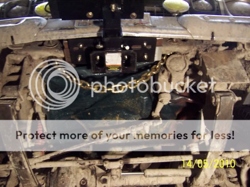

I put 10,000 Ib towing chains and two grade 8 bolts with lock nuts. Here is a pics.
