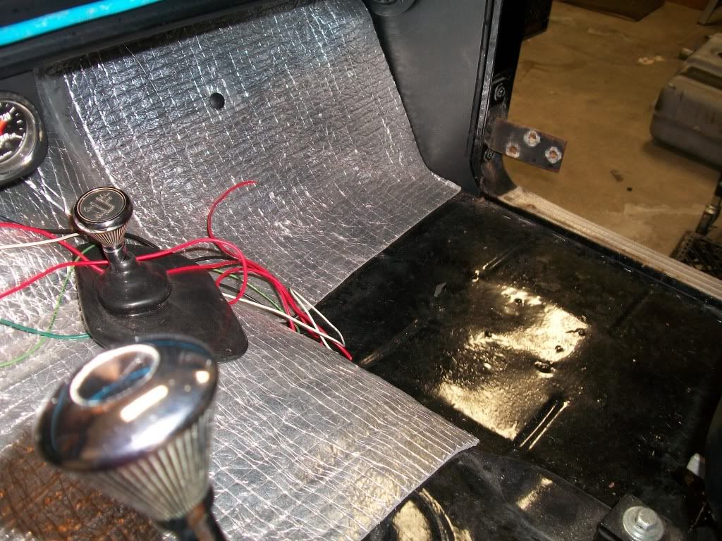

POR 15 is a good product, but if you already have eastwood rust converter and encapsulation that should be fine.
The key is to try to locate any areas where water can get into the interior and seal those areas to prevent future problems. Also maybe skip the fluffy rug mat backing and put down a layer of foil backed insulation.

I like the idea of skipping the fluffy insulation, can i just get the foil stuff at home depot? or do i need something special? sound will also be a major concern though
thanks
See this thread:
http://www.ifsja.org/forums/vb/showthread.php?t=135288
Most auto upholstery suppliers ell this stuff.

I think I bought a roll of this off ebay for like $30 bucks or so. Just cut and put down with 3M spray adheasive for trim. My interest was in sound protection as well as heat/cold.
