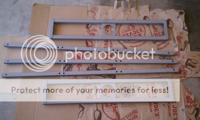

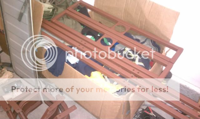

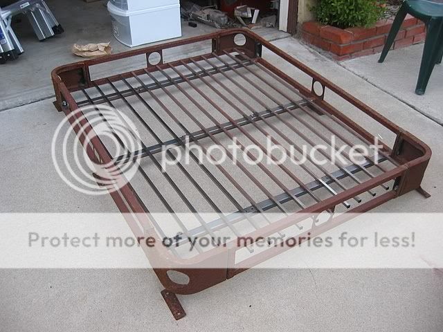

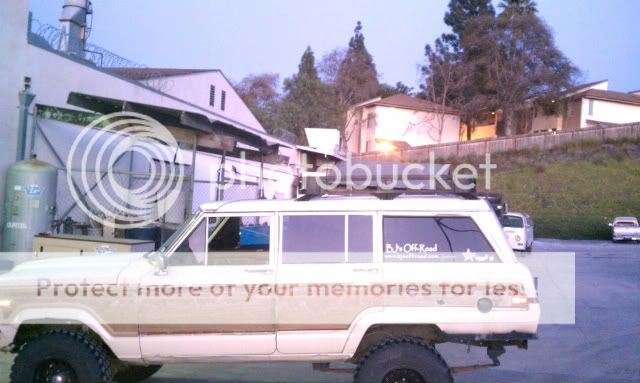

So, thanks to Babywag, I am new new proud owner of a Tad Rack. I put a little work into it to clean it up and I got it installed tonight. I am very happy with the way it looks and works. Plus, it was probibly one of the easiest installs that I have ever done. On to the pics:
***EDIT*** Pictures resized to 640X480
Rack when I picked it up from Babywag
Some of the parts back from media blasting
Some of the parts after primer. ( used rustolium spray primer)
Rack after I painted and installed it. (paint was rustolium textured matte black)
All I need to do now is to install the base racks and all will be good.

Holy Rusted Metal Batman!!
I have never seen a tad rack so rusty!

It had been sitting for quite a while. I don't think Babywag really wanted to let it go. I know I wouldn't if I were him, but I promised to give it a new home and take care of it.

Just a heads up. That's a very early rack, you need to seal the lower areas of the corners, front/rear and side pieces. We didn't do that in the first couple of years. Some black paintable caulk will do the trick.

My buddy and I used some permatex #2. We put a ring of permatex between the legs of the rack and the roof of the Jeep. Then we put another ring of permatex between the top of the rack feet and the washers for the mounting bolts. I am gonna water test it in a few days before I put the roofline back in. I am hoping that it will seal up nice and water tight.

I should of phrased that better.
Look at the inside of the corners where the sheetmetal is tacked to the square tube, that's the areas that we did not seal originally. Water will seep down inbetween those pieces.
I'll do it in a pic for you when I get home tonight, can't get to any picture hosting sites from work.
There was a post on here someplace about how/where to do this back, not sure if I can find it.
