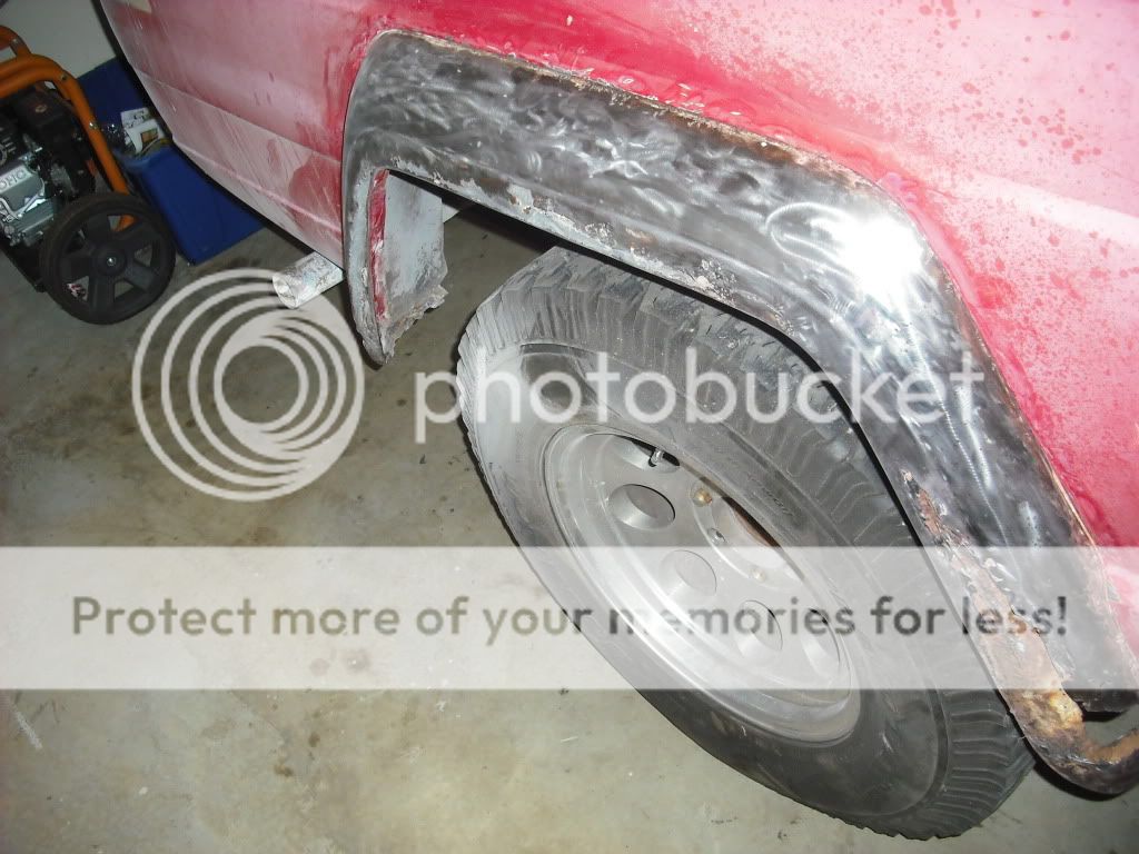

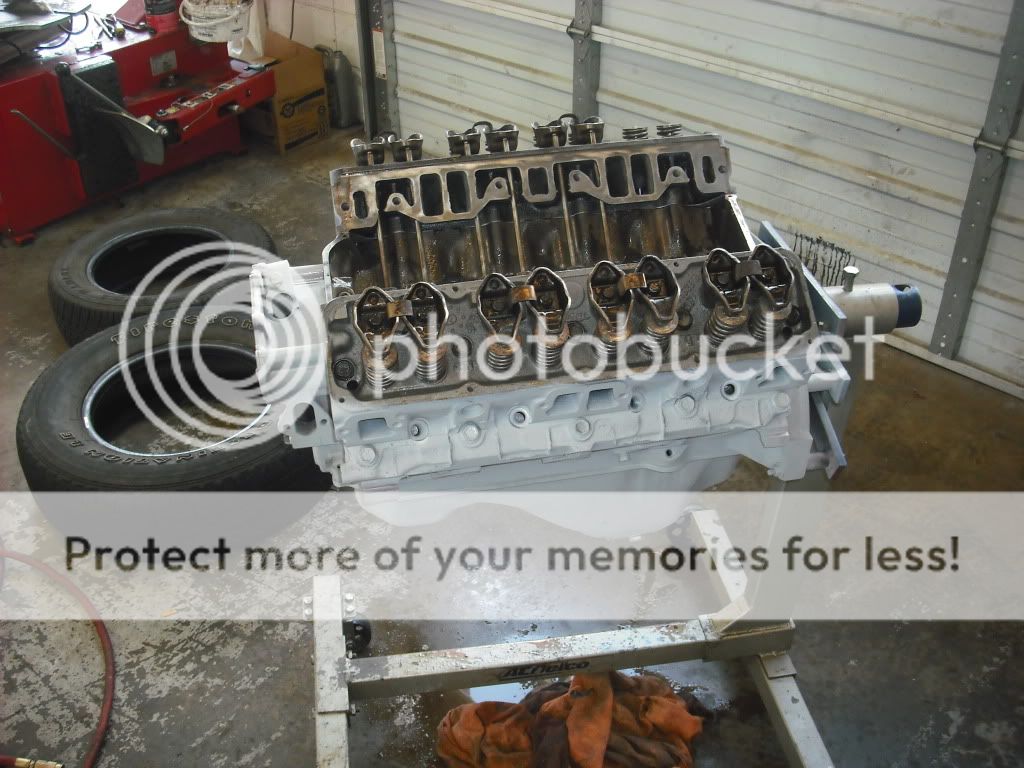

Got a decent amount of work done.
9:00AM - 4:00PM was body work. Removed the rest of the rear bumper, grinded and sanded the right rear flare (sanded to bare metal and grinded high spots and some rust). Preparing the right rear flare for fiberglass body filler hopefully tomorrow. Should be an interesting experience.
4:30PM-6:30PM was engine work. I watched Rich put on the piston rings and put the pistons in the engine. Got 7/8 in today. I cleaned the rocker arms - parts cleaner solution then wire wheel. Also brought the HEI and headers with me. Its all starting to come together now.
Hopefully will get out tomorrow and get the right rear flare done and maybe start on the left. Also do some more engine work hopefully. Thats all for now. Pictures of the engine and before/after of the flare.
Engine:

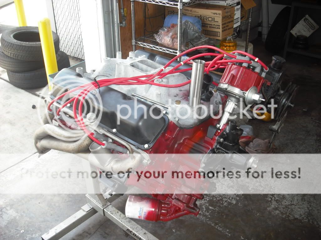

Engine is getting close to being finished. Painted the engine red (with a little black to darken it) and painted the valve covers, thermostat housing, engine mount brackets, and water pump black. Installed headers, HEI, water pump, thermostat housing, oil filler tube, valve covers, spark plugs and started to install PS pump and bracket.
Will be getting harmonic balancer tomorrow (rubber on mine was rotting) and will be ordering a remanufactured Edelbrock carb soon.
Should get everything in and running soon.
Engine:

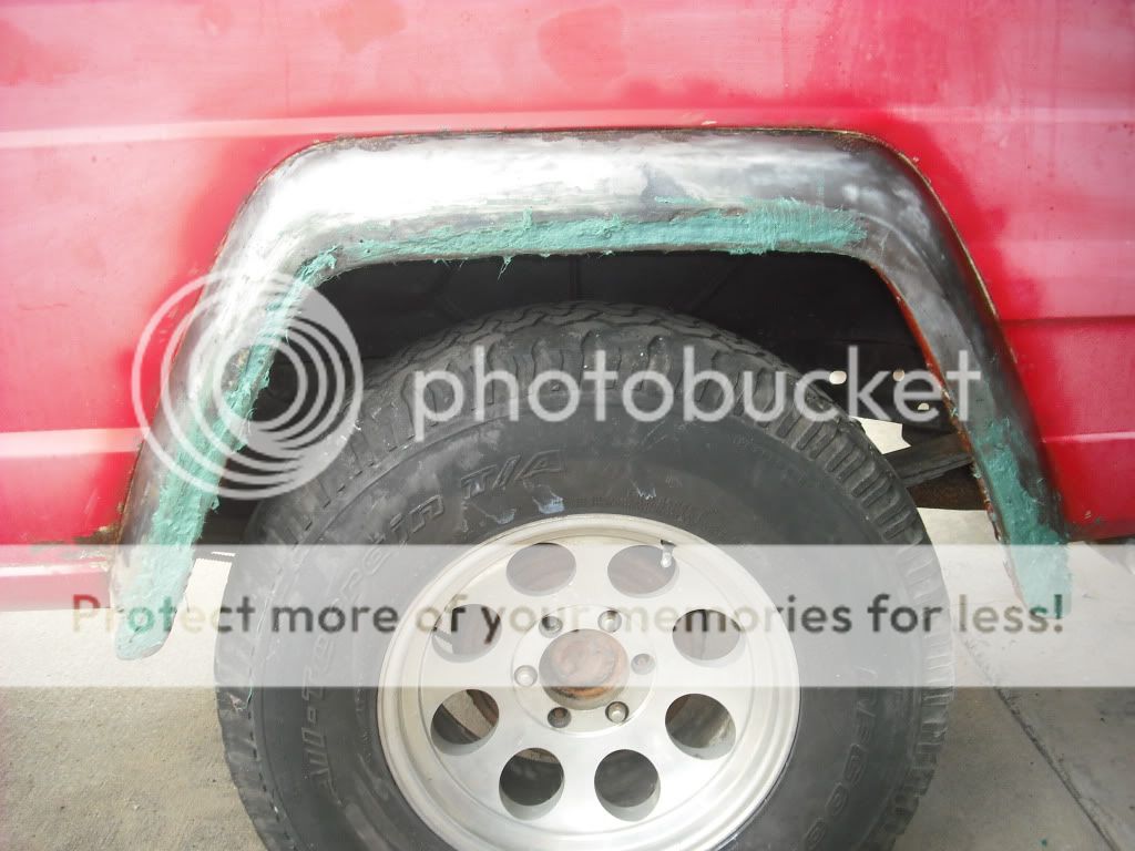

Got a decent bit done today. Grinded and cut the flares then sprayed One-Step on all the rust. After the One-Step dried I did the first filling of fiberglass filler. Will have to get another can and put another coat on. Then lots of sanding and shaping.
Right Flare:
Left Flare:

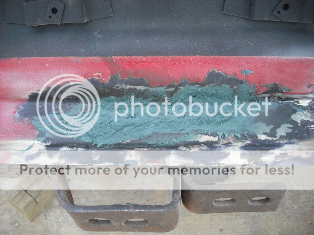

Sanded the driver side rocker panel and some random spots of rust around the door and near the roof. Sprayed with One-Step and then called it a day - 104F is too hot for Jeep work.

Just got back in again (went out at 2:15). Worked on the major rust spots on the front above the bumper. Cut out some of the metal around because it was so damaged by the rust that I tapped it with a screw driver and the screw driver went straight through. Still working on sanding around the areas. Pics later.
In again due to rain and such; got a little more sanding done around those rust spots. Worked on the rear manual window; cleaned up the gears and added some lubricant. Also did the same to the tailgate hinges. I wiped the areas that I sanded with some mineral spirits for a quick clean. Didn't spray anything cause there is still a lot to do in that area.
Before and after of one of the rust spots on the front - gives you a general idea of what I am doing:
Before:
After:
Still have a lot to do around those spots but everything is coming along. Now if only I could get that alternator bracket quicker.....
