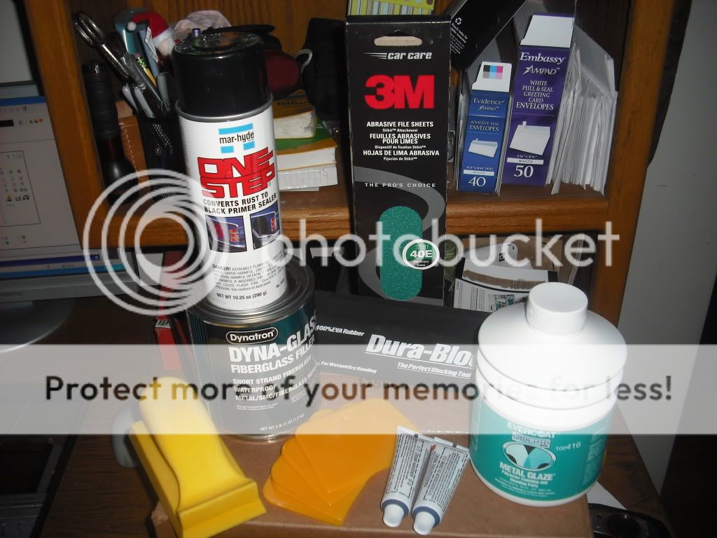

Here is the photo of the supplies I got May 24, 2010 (yesterday):

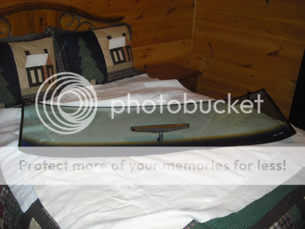

Today, I planned on picking up some Edelbrock headers from someone on the GA forum for $150. Well, I went and picked them up but I also came back with a windshield and the plastic reservoirs for free.
So the free windshield saves me about $50-$100 that I can spend on other stuff now. HUGE thank you to Steve and Mike. Steve was out in Alabama so I talked to Mike (his father) - real nice guy.

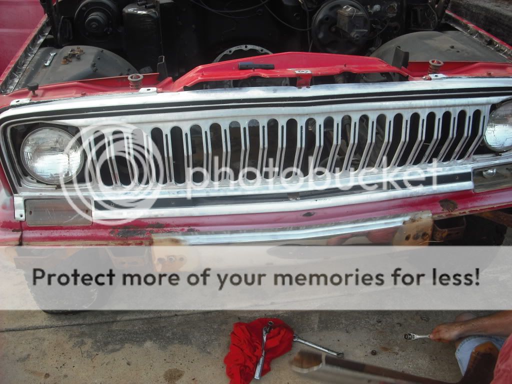

Today I did a decent amount of work on the Jeep.
Finished up the rust on the sides of the roof. Those areas are now primed and rust-free. I also used a wire wheel to remove some other rust and primed those areas as well.
I removed the side markers, tail lights, headlight pans, roof rack and bars, and headliner and trim.
I discovered some unwanted surprises, mainly rust. When I removed the roof rack there were pitted rust spots everywhere and rust under the bars. Also, most of the screws that when through the bars were rusted beyond reuse. When I removed the headliner, rust literally fell from the roof. There was soggy cardboard and surface rust coating the entire ceiling. I had to remove the roof braces for a bit to remove the soggy cardboard that was stuck under them. I also scraped some of the surface rust off of the ceiling and vacuumed it up.
I also discovered the original color of the Chero - tan.
A lot more work was discovered today. Hopefully I can get through all of it. It would be really beneficial to sand blast the whole Jeep but I don't think that is in my budget.
I also called the local powdercoating place. Considering powder coating all of the chrome trim pieces (side marker bezels, grille, roof rack, roof bars, tail light housing, door handles [interior and exterior], interior window cranks, etc.). They didn't answer so I left a message - hopefully receiving a call back Monday about prices unless anyone has an idea of what it will cost.
Pictures:

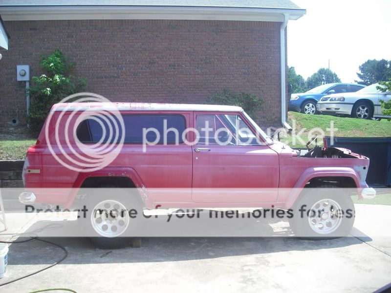

As she sits today (covered to keep water out):
Plan to work with Rich starting at 8:30 AM tomorrow. Hopefully we can get some more stuff done.
Will update tomorrow.

Just got in from doing some more work.

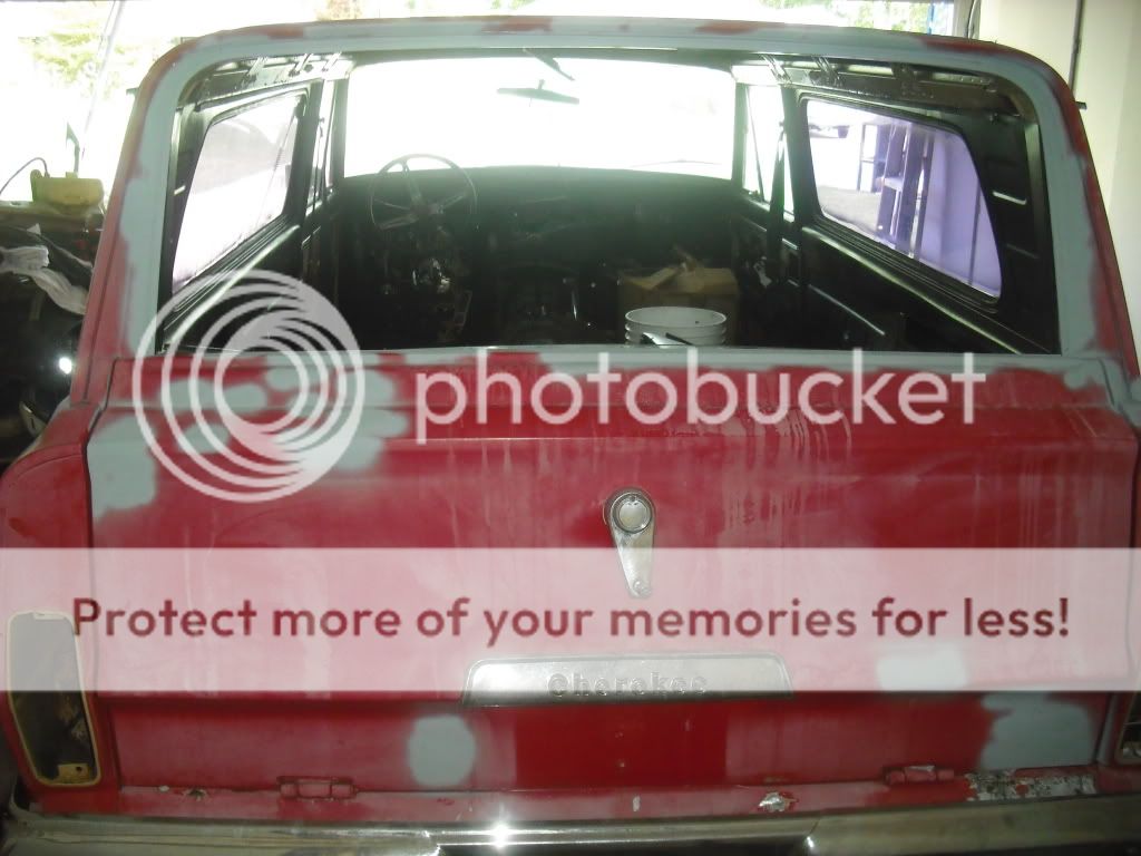

I removed rust again today. I got the small spots on the tailgate, the top of the roof (mainly under the roof rack bars), and some other random spots.
Instead of the electric drill I have been using, I hooked up the air grinder and used that.
Rich cut off the stock exhaust manifolds. If anyone wants them, you can have them. Just come pick them up. I won't ship them.

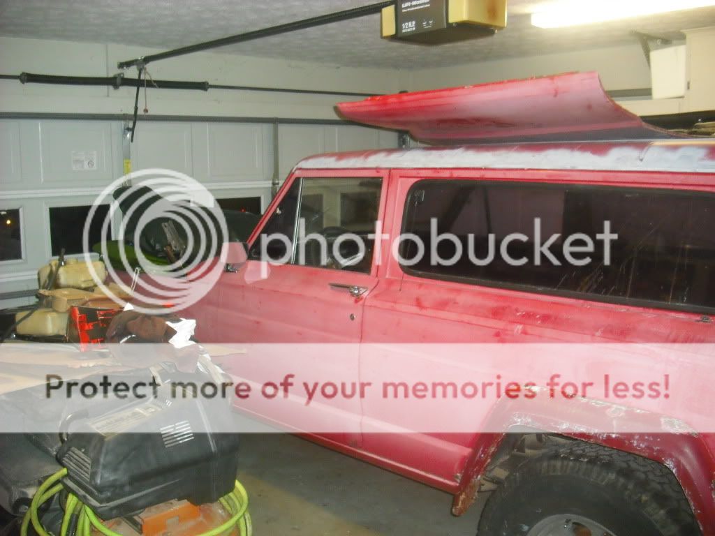

Also, I took of the hood for easier access to get some rust off.
I will probably be going out in a bit to remove some rust in the engine bay and from the hood.
Pictures:

Got back in at about 9PM.
I removed some rust via air grinder from the engine bay and the hood (didn't get too much done on the hood, mainly engine bay) - that is mainly saved for tomorrow.
Removed the front bumper with my dad and SURPRISE! more rust.... The entire back of the bumper was rusted and the brackets are rusted completely (mainly surface, not pitted). There was also some rust spots that were hidden by the bumper.
We started removing the rear bumper as well, but called it quits before I got the bolts on either end of the bumper. There is undoubtedly the same amount of rust under the rear.
Picture: - I'm sure everyone (especially slow connection) is sick of them, but they are for documentation's sake...

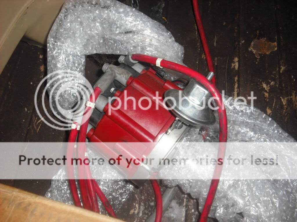

Didn't get out to work on her today due to rain. However I should be getting a HEI distributor and a 1-ton hydroboost from a member on here for $175 with $35 shipping.

Then I went to Car Color to get all the stuff he told me to get. I got a jar of Evercoat Metal Glaze (putty), long sanding block, short sanding block, roll of 120 grit Stikit sandpaper, can of One-Step rust converter and sealer, can of Dyna-Glass fiberglass filler, and 40 grit sandpaper file sheets. This all totaled out to be $139.52.

Started working on the hood today but then it started to rain. The rain has since stopped so I might go back out in a bit.
Good news: The HEI and Hydroboost came today and it all looks good.
Pictures:

Got quite a bit of work done today:
Got started on work at about 9:30. Sanded the hood and engine bay with the air sander. We removed the grille and set it aside. I used some One-Step rust converter on some areas of the engine bay that I could't reach with the grinder. Then I taped off the engine bay and primed it. After the primer dried for a little while we applied a coat of Rustoleum flat black high temp paint (two coats).
Just removed the tape and the paint is drying the rest of the way. It turned out okay. I will have to redo the heater box because I sprayed some glossy paint to see what it would look like and I didn't like it. When the flat black was sprayed over top of it, it left some unattractive markings.
She is now back in the garage. Got back in at about 5:10.
Pictures:
Thanks
