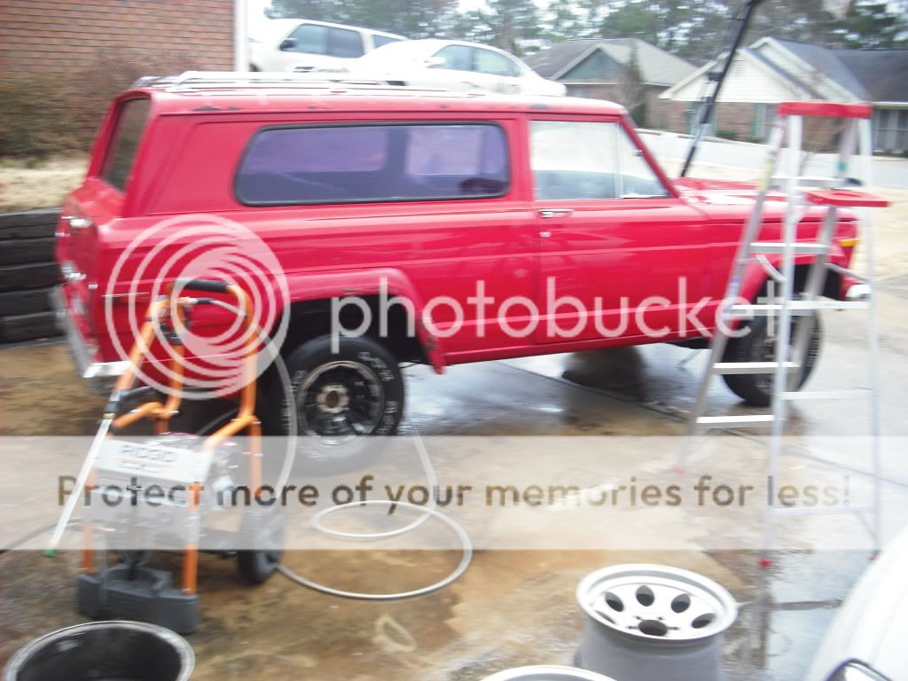

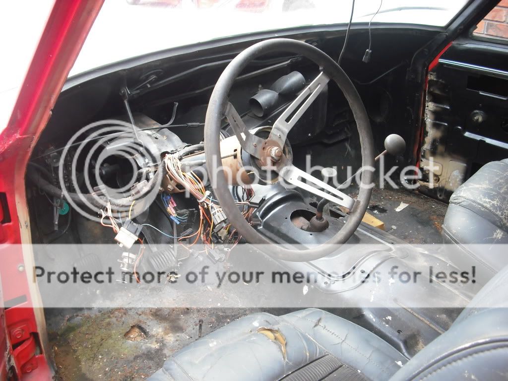

Here are some pictures:

Oxidization, will take care of that.
Under the hood.

Random Parts
Inside
