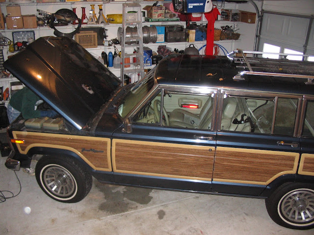

Old 12-23-2009, 07:05 AM
t_g_farrell t_g_farrell is offline
Join Date: Sep 30, 2009
Location: Huntersville, NC
Posts: 26
Ok, I have one poor picture so far of me working on it in my garage.
This things huge, I have to put it in there at an angle to close the door.
I removed the air pump and air injection stuff and will be replacing hoses
and rerouting vacuum lines to finish the emissions delete. Picked up an 89
SHO taurus eletric fan to replace the clutch fan and also a TFI coil to use
the the TFI upgrade at the local pull-a-part here in Charlotte.
Old 12-23-2009, 07:16 AM
Posts: 4,775
Nice color!
Old 12-23-2009, 11:14 AM
Posts: 26
Yeah, its a really nice blue and I think original. Theres a couple of really minor areas where the clear coat is lifting but nothing worth fixing for now.
For anyone who tries the electric fan upgrade in the future, an 89 Taurus SHO electric fan won't clear the front pulley bolts Back to pull-a-part to grab something with 3.5 inches or less to clear the bolts.

So I replaced the fan clutch mounting studs with hex head
bolts but the clearance was still lacking. I did some more
research and it looks like a dual fan from a Plymouth/Dodge
minivan 95-99 or a chrysler new yorker late 90s will work.
I'm taking my tape measure this time
Old 12-26-2009, 02:03 PM
Posts: 26
Nabbed a 93 New Yorker dual fan setup and it will fit perfectly.
Just add some brackets and drill a few holes to get it on there.
