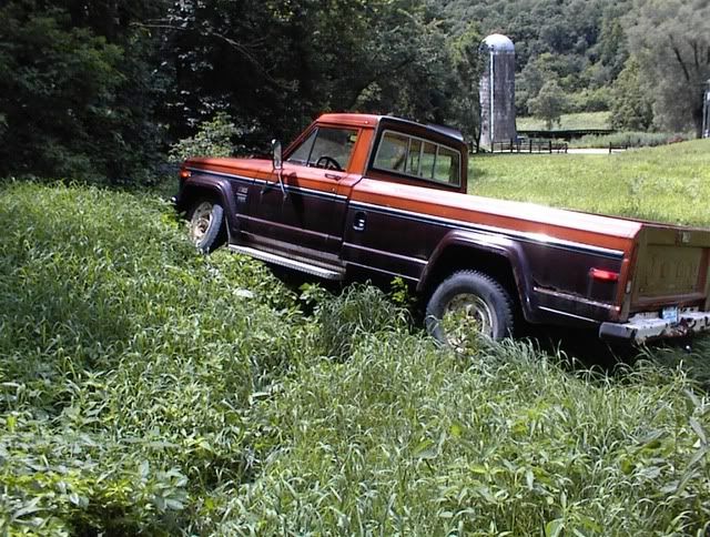

So here is what I am starting with (this is the day I brought it home)
The tag "Thummer" came from my buddy and I having to hitch hike (thumb it) on the first test drive...he said it best, "the engine sputter then the only sound we heard was the price dropping" and another member posted on that thread "it was love at first stall"
and the new tag "Thumper" is a good transition and anyone that has ever ridden in an 8400 gvrw J20 knows it will thump you on the bumps

I grabbed the "blue wrench" and cut the box bolts, the comealong and some chains and
Truck had enough gas is the carb to move it out of the way
PARTIAL NUDITY
Box fits on my biger trailer like it was made for it
Here is a good shot of how my rear spring was broken
I got a used spring from a member to replace it for now (I have a line on a set of NOS from another member I probably will get)
Figured I should address my lack of rear bump stops now too (BJ's is great 1 stop shopping)
The tank nuts came off, I think the PO dropped the tank when they patched it, there patch and mine did not hold
I have a used tank to put in, going to try to patch this one for a dual tank set up.
Working on my temporary flat bed now to get the thing driveable again.
