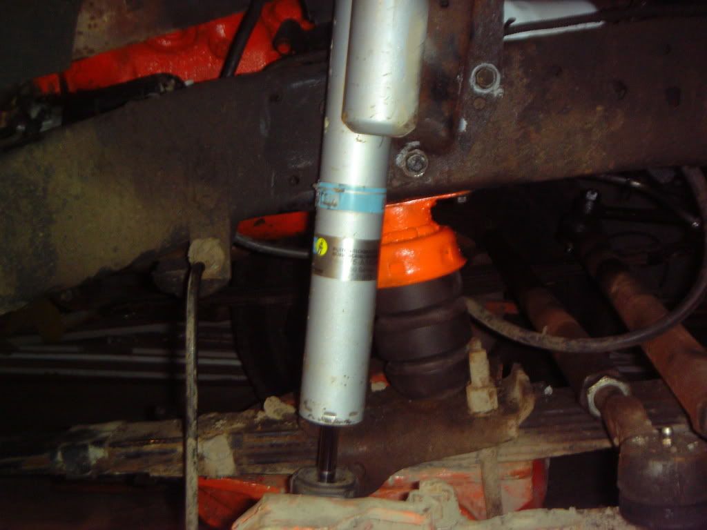

When the D60 went in up front I went with the progressive rate bump stops, at the same time I built new brackets and moved them back a few inches to keep them out of the spring plate/sway bar mount.

I run rear S10 bumpstops on mine and love them. They're a progressive bumpstop and cost $5 a pair at the local junkyard.

I set mine up to act a bit like a swaybar and they're not hard at all. The ride is like night and day compared to before. It handles 200% better. Best $5 and 15 minutes I ever spent.

You don't want to invert so it needs to stop the suspension before it goes beyond flat or you'll wreck your new 4" springs. Progressive bumpstops are even better as they start slowing the suspension down before "full bump" and make your truck handle better and smoother. So the question is, why wouldn't you want bumpstops?
