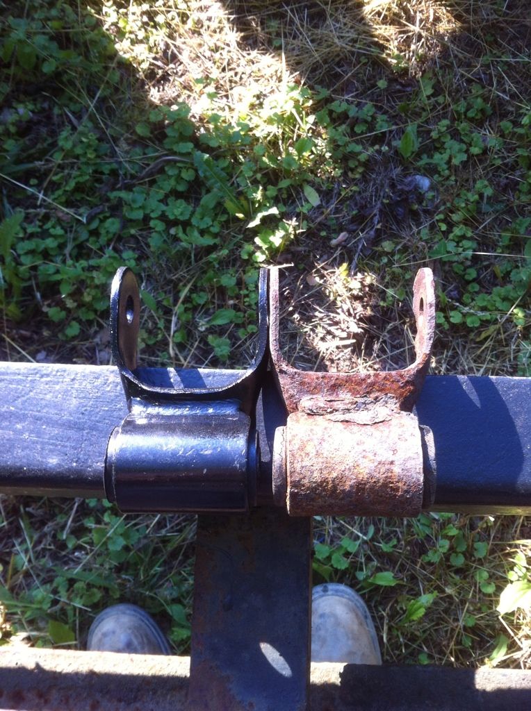

ok guys got the xj shackles in today and its a crown automotive pn 52000507. they were 20.99 on 4wd.com and when laid next to a stock j10 shackle they are the same.

Wow, now I see why you need new shackles.In california a shackle is generally a non wearing part. Maybe the bushing but not the shackle.

Yup gotta love the east coast
And that pic is of the good side the other side is about half as thick

Hey, looks normal to me.

I probably would have put it back on
