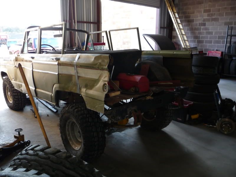

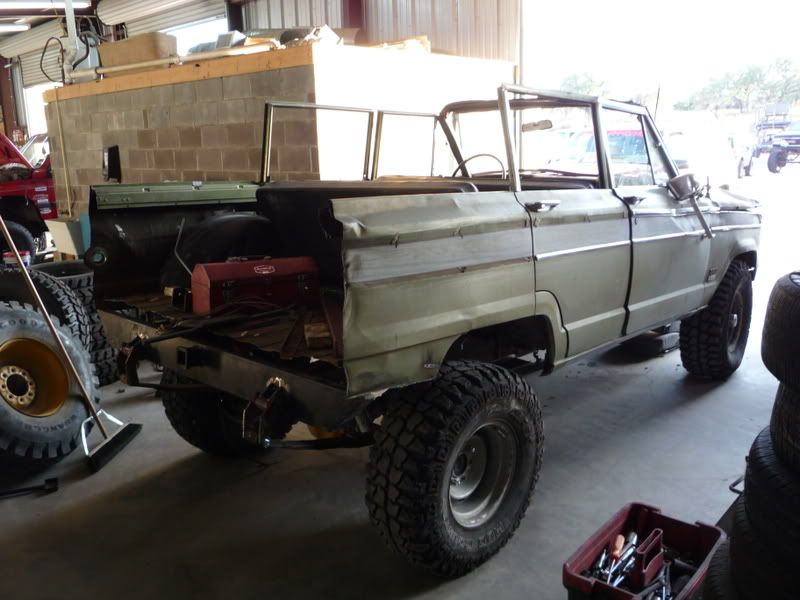

today...
well i didn't get as much done today as i had hoped the wife is ready to have our son here any day now and i got tied up with that but i did get the first cut on the rear and the bumper remounted so i can start fabbing the shackles and with no further adoo heres the pics.......
and just for laughs heres two pre rollover
i'm still a lil upset with myself about rolling it but....it'll be better soon...ish anyway

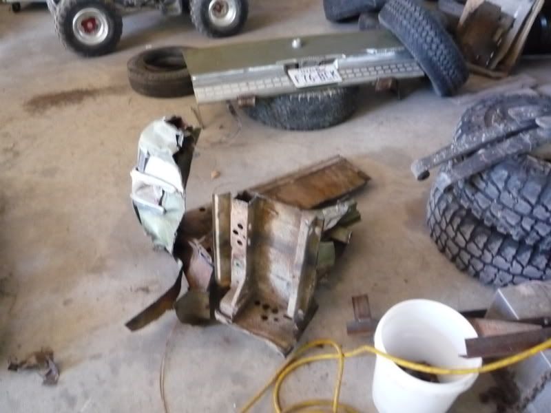

more pics
what got removed so far
with the bumper temp mounted

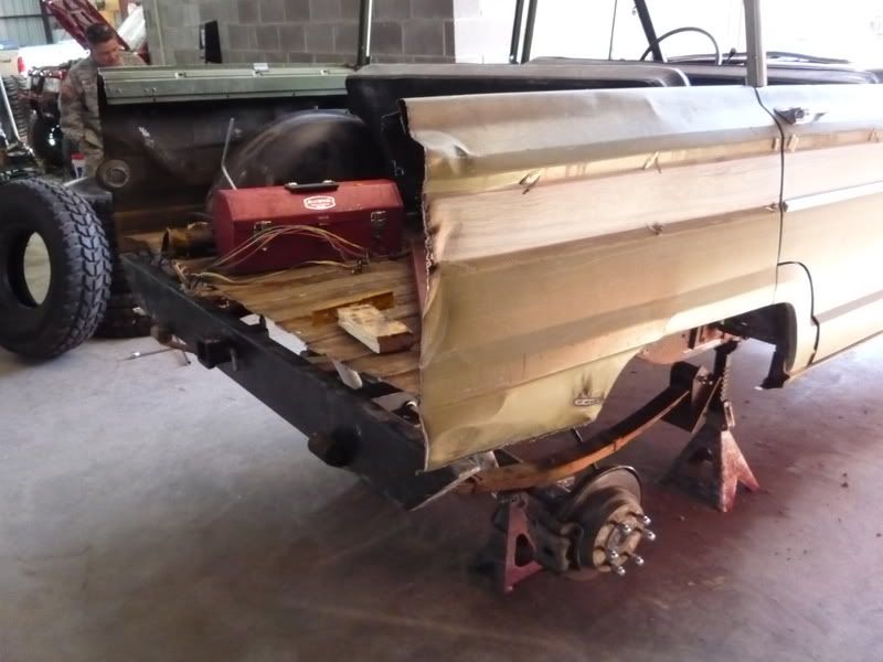

today
thanks! as fun as the cj woulda been the waggy is just cool you know? i didn't get too too much done today but i did get the rear spring mount stuff sorta done everythings tacked together and tacked or clamped in place hopefully tomorrow i can get the rear square in the wag and where i want it and burn everything in......looks like it wound up a ton higher than the 4" springs and 2" blocks....the goal is to clear 37's and i'm pretty sure we have that covered no problem i think it might even have to come back down a hair or too
these are 33's in the pics for reference
