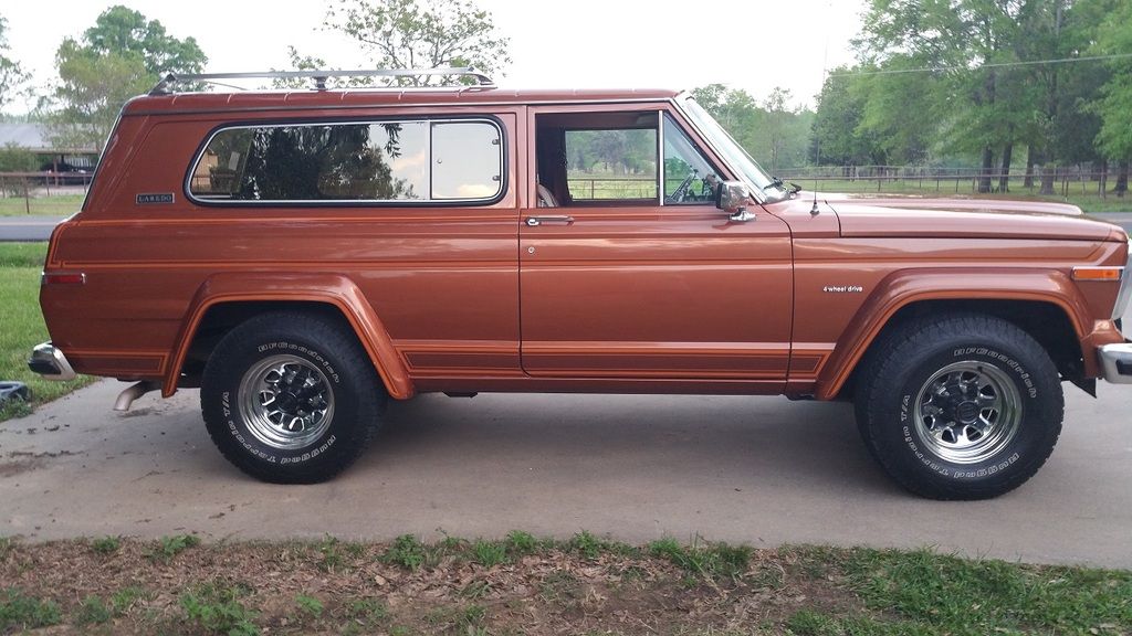

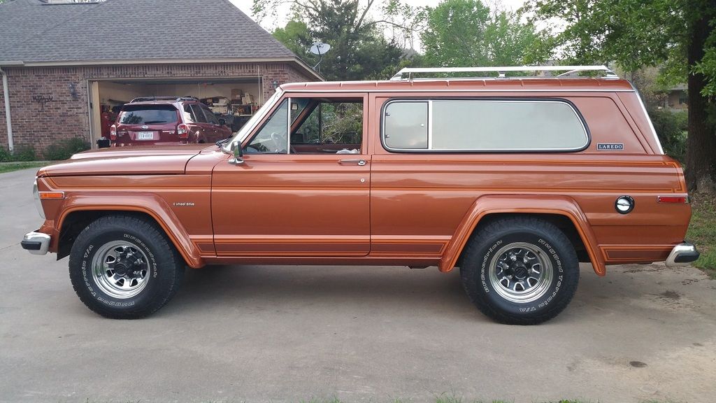

After much procrastination, I was finally able to get my hands on the Phoenix Graphics Nutmeg Stripe Kit for my Dads 83 Cherokee Laredo. Thank you Polarfire for the kit and contacting me via facebook.
[IMG][/IMG]
[IMG][/IMG]
[IMG][/IMG]
[IMG][/IMG]
First thing I must say after many hours of carefully installing this mammoth amount of graphics is that it absolutely makes the Jeep. For some reason these graphics just work to highlight the body lines and I think it looks fantastic, of course that is my opinion. You check out the before and after pictures and you decide.
Now for comments on the kit, the good and the not so good.
The quality of the graphic vinyl is real nice, it has rich colors and is well made. It would be nice to have identifiers to go along with it, but I think we are all smart enough to figure it out. This kit is a combo kit intended to be used either on the FSJ j10 truck or the FSJ Cherokee Laredo. It was obviously designed primarily for the Truck, the Cherokee application got the short end of the stick. There were a few pieces included that were specifically geared toward the Cherokee (the tailgate graphics and the side pinstripe terminating piece at the back corners) but there are other specifically Cherokee Graphics that were missing.
So let’s look at the installation.

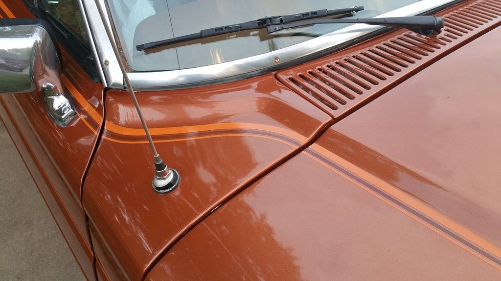

Starting at the hood. The large “L” shaped graphic that runs down the ridge in the hood had some issues. Mainly the angle of the “L” was too small. This caused the front edge to not be parallel to the front edge of the hood which also caused it to fall to far back on the fender where the fender graphic ties into it. The solution was to tweak the angle which meant cutting the large stripe to correct the angle. Also, this graphic is about 1 ½” to short front to back and about an inch to narrow side to side. This ultimately meant that the fender graphic is moved to far back and does not follow the body line correctly and that the hood graphic can’t follow the hood line or it won’t make it to the bottom edge of the hood. I overcame the fitment issues as best I could and it looks okay.
[IMG][/IMG]
The cowl “S” graphic laid down nice, but “S” shape is not exaggerated enough to follow the body line.
[IMG][/IMG]
[IMG][/IMG]

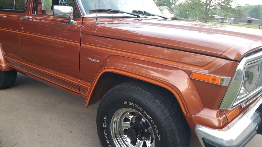

The sides went well, with the exception of three things, one that is major, one that is okay and one that is no problem. Starting with the major one, the lower rear quarter graphic behind the wheel is a piece that is specific to Cherokees and was “NOT” supplied in the kit. It is a piece that is tapered and ends before the bumper. The piece supplied in the kit is for the Truck application, which is too long and not tapered. I installed it anyway and it looks “okay”. The second issue has to do with the long side stripes where they meet at the back terminating graphic, all of the stripes are designed for the truck with 90 degree terminating ends, the Cherokee would be set at angle, so I had to trim it to be parallel to the terminating graphic, which upon closer inspection looks weird. And finally, the lower graphic behind the door, the kit supplied the piece behind the door for the truck, but in the Cherokee application, the front lower piece for the truck bed needed to be modified to fit and trimmed to match the door.
The tailgate pieces fit nicely.
The fender flare stripes fit good, but they have a little too much arch at the top. I tried flatten them but it was putting too much stress on the vinyl and it was going to get a crease in it, so I let it go.
[IMG][/IMG]

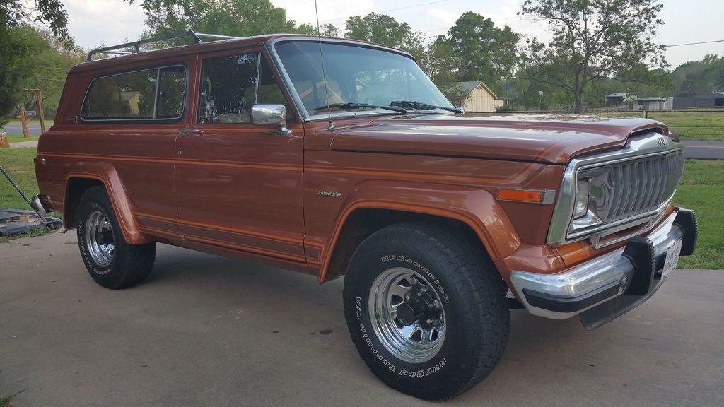

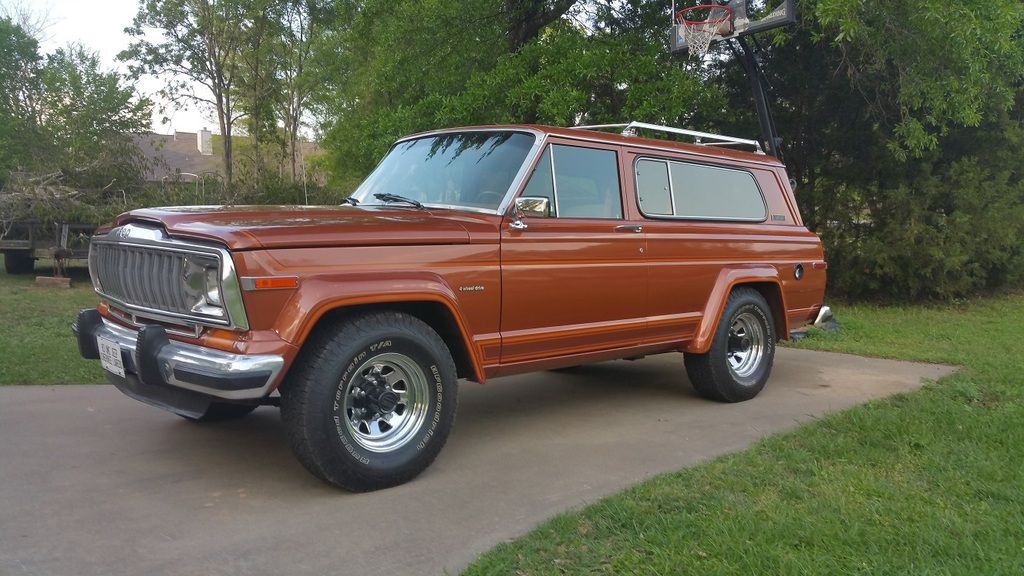

So, at the end of the day the Cherokee has graphics and I think it looks great, even with the flaws, but I hope Phoenix Graphics will see this and make strides to improve the kit fitment and make it fit the Cherokee better.
One final observation, there were a large number of unused graphics doing the Cherokee, it is a shame that so much is wasted in this application.
[IMG][/IMG]
The price could be reduced a little if a specific Cherokee kit were made. But I get quantity of available market and how limited the number of buyers are, so hats off to Phoenix Graphics for making this kit for us.
