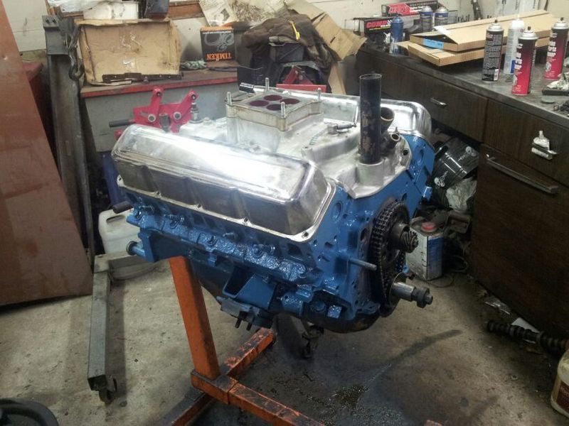

Old 09-15-2012, 10:14 AM
jeepjerry's Avatar
Join Date: Oct 12, 2008
Posts: 1,781
Well, havent gotten much done in the last month. I got married and then went on a honeymoon in Florida! That was a blast..
Some progress on the engine. Getting closer to pulling the beast into the garage.

Old 10-03-2012, 08:02 PM
jeepjerry's Avatar
Posts: 1,781
Got the engine about together and ready to drop in. Still need to get a 360 flywheel.
