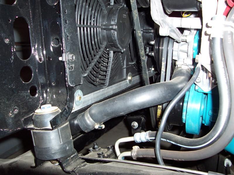

Just updating some of the progress and pics, on my now long term project.
The stock two bbl that I used to get the motor up and running has been replace by a TA470. With one pump of the accelerator lever, it fires up and idles very nicely..!
Also the stock exhaust manifolds have been replaced by Thorley's which I have more pics on in this thread I posted earlier. http://www.ifsja.org/forums/vb/showt...light=thorleys
Also fixed a cooling issue due to a bad clutch fan that was purchased brand new out of the box.
Decided to to get rid of the clutch fan and shroud setup, and go electric.
There are several, and cheaper ways to go electric other than my way.
What I chose was Jegs 555-52118 dual 12" 3100 CFM fan.
http://www.jegs.com/i/JEGS-Performan...52118/10002/-1
And a Painless Performance fan relay kit.
http://www.jegs.com/i/Painless-Perfo...30102/10002/-1
This thing really pulls the air, fits the width of the radiator perfectly, and covers all but an inch gap along the entire bottom of the radiator.
I welded a mounting bolt on each side of the lower part of the radiator to bolt a 1/4 x 1" thick aluminum cross bar to. The fan rest on this, by bolts and large washers I threaded into the recessed nuts already mounted in the fan housing.
I added an aluminum spacer an a few washers on the bolts I welded to the radiator to adjust how tight the fan housing would contact the radiator when tightened down. First pic is view from the front. Second pic is view from back of the three bolts with washers supported by the the cross bar.
Bottom view
For the top, I used the same type of aluminum stock to hold the top portion of the new fan assembly tight to the radiator. I used the existing radiator mounting holes for the installation.
Now mounted up, the fan assembly is rock solid.
Well, thats all for now. Hoping that the next pics I show, are of a newly painted Cab sitting on the chassis.
