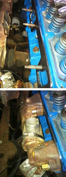

Did you really mean "studs", or bolts? I started using SS bolts, but my last time around I upgraded to actual studs. Also makes installing gasket & manifolds a pleasure. And yes, the gasket is a nice thick Remflex....also highly recommended.
Note the use of the long brass nuts. In addition to not corroding, they cover the length the stud, thus preventing stud threads from rusting, whereas if you used regular size bolts, there would be thread exposed to rust. If SS studs are available, I'm not aware. Suppose I could have cut my own, come to think of it.

I already have SS blots that go into the heads. I mean where the Y pipe bolts on the manifolds.
