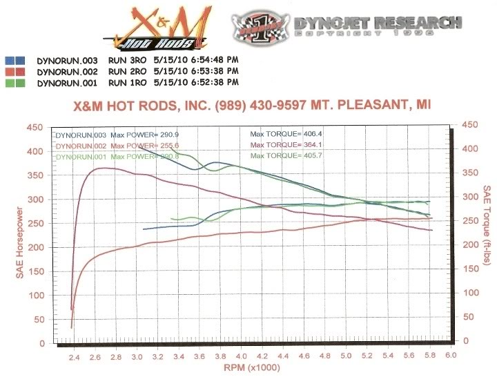

      Originally posted by Ghinmi
      I built pretty much exactly what you're talking about. Took a bone stock 360 and added a Comp Cams 270H cam, lifters, and springs. Also put on an Edelbrock air-gap intake, holley carb, and Edelbrock headers. The ignition is upgraded with an MSD box. Aside from that the engine is all original. I put it on a chassis dyno and made 255.6 hp / 364.1 tq to the wheels. Easy as cake.
      No reason not to go a little bigger on cam if you want.
      Don't "need" pistons to make power, Don't "need" race gas if you do replace 'em.
      As in your other thread opinions vary, but in real world these do make power even with stock cr pistons.

          I don't think he's looking to make big power, I'm guessing he's not even looking for a horse power per cubic inch.
          There is more to power than just compression and cam. Those are merely items to support MORE power. Flow is what makes power.
          If you took Greg's formula quoted into a previous post, and combined that with some headwork, you could have a 300hp (to the wheels) 360 very easily.

                      Yeah, cuz those dyno sheets lie like the dickens
