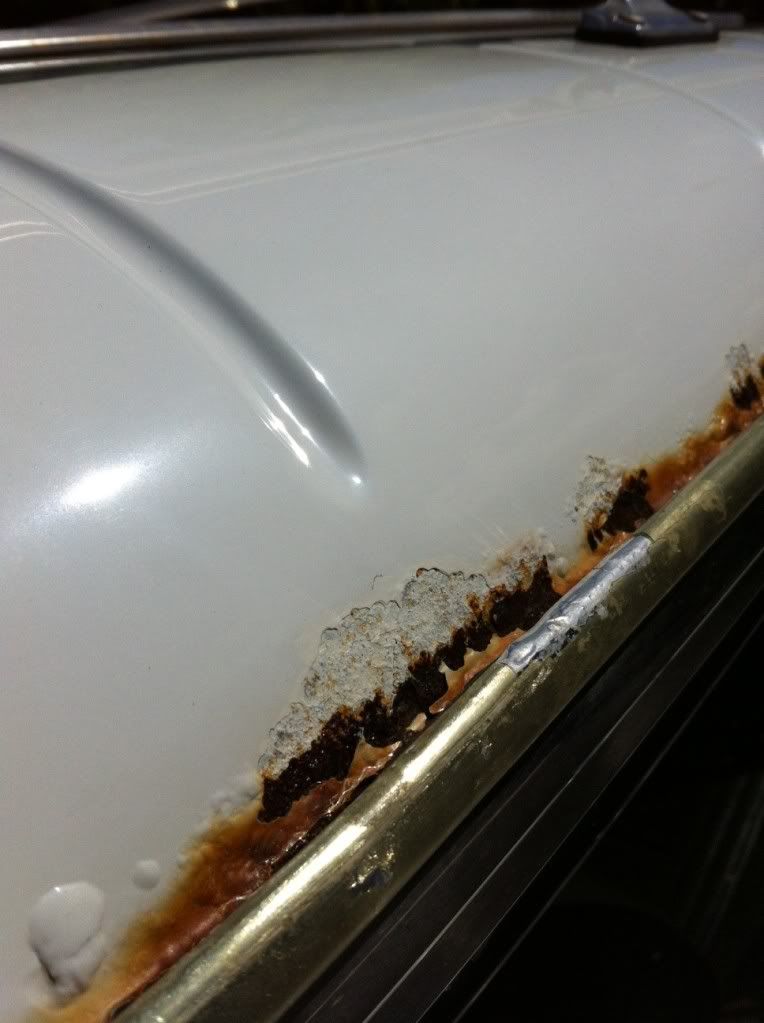

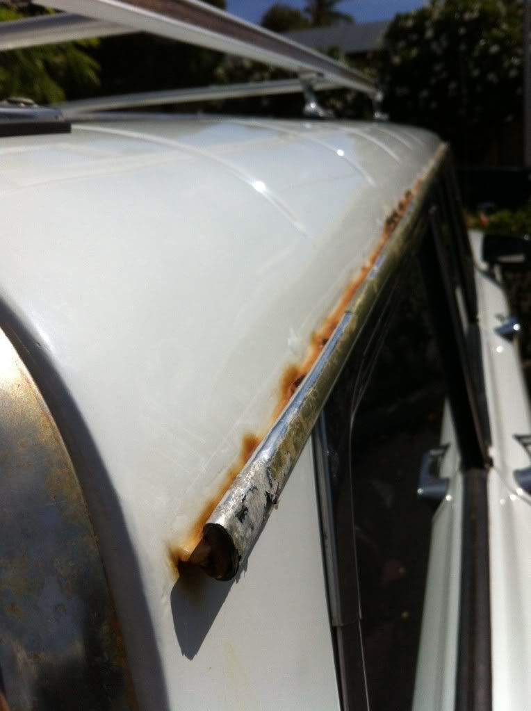

So even though my wag received a new paint job by PO a few years ago rust is winning the war on my drip rails.
I was able to score some stainless trim on my recent trip back to Texas and after a $50 shipping fee I really want to put them on. Before I do I'm thinking I need to fix my rust problem ASAP. I'm really just looking for a 5 year fix until I can weld in and have the entire vehicle painted.
Here are my options as I see it:
1) Take it to a local body shop and pay to have the rust removed, holes filled with fiber-glass and get the entire roof repainted for $1K.
2) Removed the rust myself, por-15, fiber-glass, seam seal and repaint with custom matched aerosol. I'm thinking I can feather the paint and color sand since there's no clear coat on latest paint job.
3) Hoping you guys can give me more ideas.
Give me some opinions/experiences please!

I plan on using POR15 on mine, maybe the 2nd choice would be the best. It may not be the best looking solution but definitely better than paying 1k for the shop to do it.
How much would a new paint job cost? Maybe you can repair it yourself and then have it repainted. I guess it just depends on how much you have to spend and how much work you are willing to put into it.

Wanted to bring this thread to the top for more opinions. I've been side tracked with life but I've got to get started on this. The rust is getting worse by the day.
I do have the ability to paint the car now but my rails are practically gone.

Cut them off, fill in the gap and have a nice smooth roof line.

x2, only thing drip rails are good for close to the ocean is RUST.

No pics, but as a body man, I really hate life when owners try to fix something without the knowledge of what they are doing. That said, if you have experience with welding and body repair, cut it out and go for it. If not it will be cheaper in the long run to have the "pros from Dover" do it.
Goingto have to cut out the bad stuff and get to good metal no matter what or it will just keep creeping.

If I were determined to fix the rust, I would start by abrasive blasting the areas in question. That would give you an idea of what you have to work with, and remove the existing rust. Coatings over the rust are delaying measures at best - to fix it properly, you need to eliminate the rust and replace the damaged steel.

I do not think fiberglass is the way to "Fix this" fiberglass fixes fiberglass. To put it over rotten metal is a poor patch. To "kill the rust" you have to remove it by blasting, wire brushing to a total clean level, or cut it out and weld in new metal.
I am no professional on this, but have done extensive research. Por is a great product, as are several other rust preventives, They work very well "if" you have all the rust removed, but if you research what the "body men do" they remove the rust and use an epoxy primer.

Having done body work as a professional, fiberglass would be a big no-no on a roof!
Might just as well use duct tape or foil tape...
If ever in an accident or rollover you want the roof to be strong enough to not tear off or crush your noodle.
Only way to "fix" it is with new metal, cut out the rust and weld in new.
Can replicate the drip rail, or remove it.
For an idea on what's involved for the OP look @ this.
http://www.scottshotrods.com/56FordT...valInstall.asp

Thanks everyone for the opinions. My situation is that I'm stationed in Hawaii and will be moving back to the mainland in 2 years. My welder and shop equipment are back home so I was just entertaining the idea of a stop-gap fix that will retard the rust for a few years.
If anyone wants to fly over with patch panels and a welder I'll pay for the plane ticket!
I do want to fix this correctly but I'm stuck here with limited resources and I realky dont trust the body guys here I've talked to.

Take it to clean metal and then fill the area with Panel Epoxy. Not as good as replacing the rusted metal but stronger than filler and sandable.

Pull the headliner and see how extensive the rust is on the inside. You need to remove the rust first and seeing the inside will help determine how much you need to remove. You have to cut back to good metal to treat it if you want to stop the rust. If you cover it any other way it will be back in a year or two. Good luck.

If you are going to bring it back in a couple of years, pull the headliner, clean it as best you can, treat it, glass it over and paint it, even with a rattle can. That should hold you for that long. Since it has been around 2 years since the original post and pics, you are probably a little past economically saving that panel. When you get back to the mainland. look for a decent roof panel and replace the whole thing. You can grind out the spot welds all the way around after you pull the w/shield and rubber, then drill out the spot welds on the replacement and plug weld it on.
