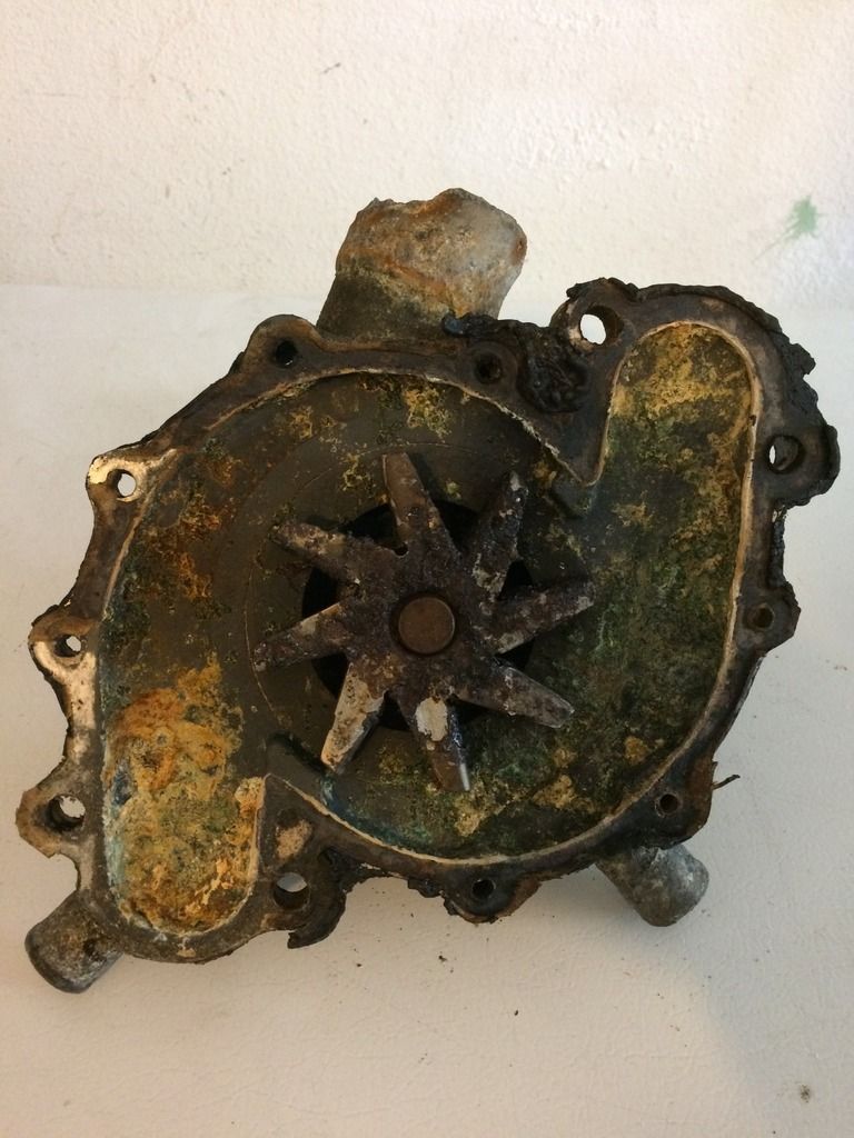

Swapped them this weekend. Here's the old one! EGADS! it's a GMP pump (has their logo and "JAPAN" embossed on the housing. This thing is GRRRRoooooosssss!

Good job gettin' that done, especially if ya didn't break anything! I'm a little surprised how corroded that is. Even my cooling system isn't near that bad. Now everything else outside of the engine... well that's another story!

I'd hate to see what your aluminum timing cover looks like. EGADs is right! That looks to be the product of typical Californian maintenance (running straight water/no anti-freeze coolant)

Totally! My timing cover was very pitted but seems to be holding (so far). I am worried about how the inside of my block/heads look.

What's up with that? PO run straight water?
My iron pump had pretty significant rust (slightly more than just surface rust) on the outside, but inside looked brand new. Inlet/outlet had no rust at all.

Thats what hapens after years of filling up the radiator with a garden hose with or without coolant. Especially if theres a lot of minerals in your water.
