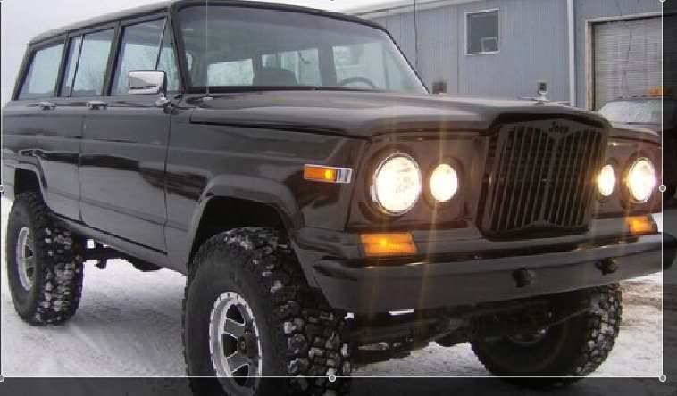

have you ever seen these? grand wagoneer pie pan lights
what are these middle lights that should be pie pans. anyone ever seen this type of setup

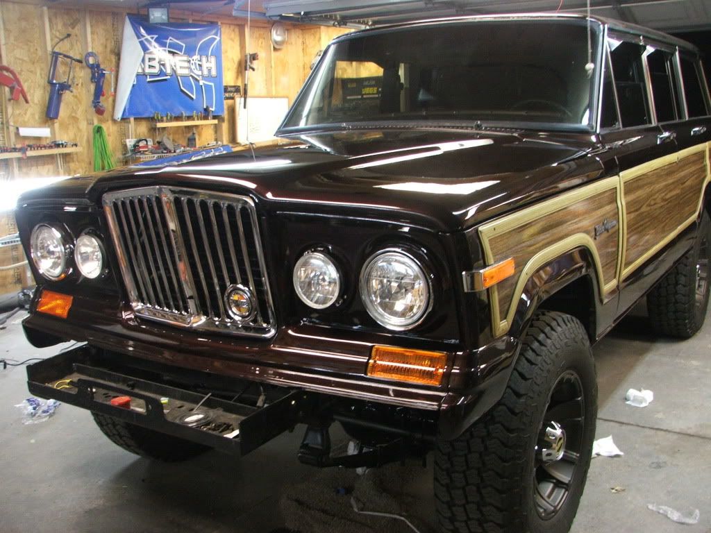

Like these?

thats way beyond nice. how would i go about doing that.

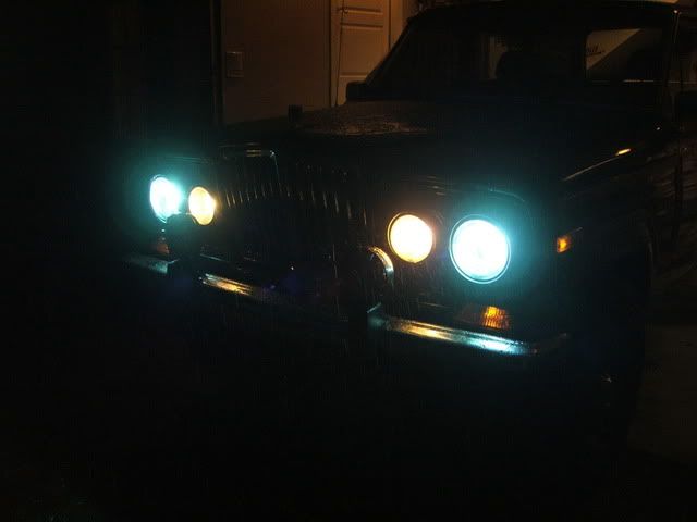

This is them on wired to the brights,w/a relay to keep the low beams on.I used 3000K 100 watt bulbs for the yellow look.great in inclement weather.

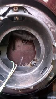

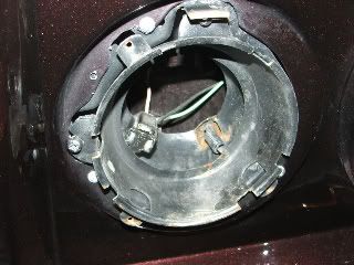

This is how I moved the spring retainer.You don't have to do this if your running stock style lights.Top pick is pass side bucket cut out to clear A/C drier
I know this jeep.
thats Ted's, head tech from National 4wd fredricton NB. Canada
very nice rig, he spent a lot of time and money on it. built it for tow rig for his wife to drive.
here is a link to the build thread on Nova Scotia jeep club site.
http://nsjc.proboards.com/index.cgi?...y&thread=31018
here is a pic of an old waggy that I was going to buy the front off of last year but never had time to make the 5hr drive. it had lights in it. someone told me on here at the time they were factory foglights if my memory is correct.
as far as the grill in Ted's jeep he had it made. after spending big big$$$'s doing the jeep over he just did not want to fork out hundreds for a grill on ebay. he and his wife wanted it black anyway.
