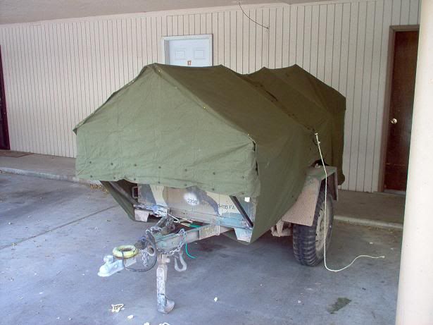

The shelter halves came in so I mocked everything up on the M416. I had a bunch of tent poles laying around from a couple of tents that lost a battle with the wind so I used those for the frame.
I didn't have the canvas on straight but it was enough to get a feel for the project. Lots of room on the inside however I need to come up with a sturdier frame or get some heavy duty tent poles if I decide to go that route.

Glad you're feeling better, but that trailer doesn't look anything like an Expedition. I drive one at work and I can tell...
I do think you're on to something tho, lots of potential there.
Thanks! I believe they call it an expedition trailer due to it being in the upper weight range of what an Expedition can pull. j/k
Speaking of towing I have a bit of a dilemma. The previous owner of the trailer hacked off the lunette ring then welded a driveshaft over the lunette shaft. So far it's worked great but the last person that borrowed the trailer broke it while backing up.
I'd like to replace it with a reproduction lunette but my J10 does not have a receiver hitch. Is a there a way to put a pintle hitch on a step bumper without hacking it up?
If I don't go the pintle route I'm going to go with the Max Coupler. It attaches to the tow vehicle in place of a trailer ball. Found a write-up on this device in either JP mag or 4WD mag.

Got a little more work done to it since I last posted.
Welded in some steel connectors for 1/2" EMT conduit to hold the frame work for the tent
Used 1/2" EMT conduit for the framework. Came out WAY better than the tent poles
When it's done there will be bungees or ratchet straps holding the tent down so it's nice and tight. The loops for the tent stakes actually line up perfect with the metal tie down hoops for the canvas transport top
Turns out the shelter halves are a few inches shorter in length than the body of the M416. It ended up working to my advantage because it puts a lot of tension on the frame work so the canvas is nice and tight.
Still have a lot of work to do: tailgate needs to be fabricated, gotta make a rack to hold the jerry cans, interior has to be cleaned up and covered with DIY bedliner. Also have a pair of 40MM ammo cans that need to mounted for storage of the shelter halves while not in use, after that a new set of NDT tires and a canvas transport top to top it all off with.
