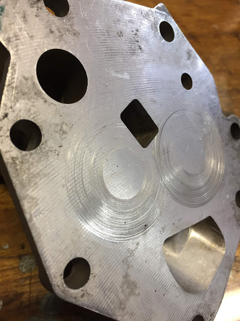

Okay, worked on the oil pump end cover, used a piece of glass and valve lapping compound.
1978 Wagoneer
Mods:
Old 07-24-2018, 07:46 PM
Full Size Jeeper's Avatar
Join Date: Jul 20, 2014
Posts: 2,466
Took about an hour and a half to get it good enough for me.

Before.
1978 Wagoneer
Mods:
Old 07-24-2018, 07:50 PM
Posts: 2,466
After.
1978 Wagoneer

So to my thinking, the timing cover mating surface is not flat or the top surface where the gears sit is worn, the drive gear side is more worn than the driven gear side by .002. Also the gears to cover has some grooving, but the thickest feeler gauge I can insert is .003 on either side. So with that said, do I have A usable cover? Thanks in advance.

So, should I lap the timing cover side to try and tighten up the clearance a little. The TSM say 2 to 8 thousands is spec, but .002 is preferred. Also I will never be able to get rid of the .002 difference between the gears.

lap the cover till the tolerance is nil,but the gears turn freely. it will increase as it heats up. i just do mine feel. if it's off the engine,yes i would work till i can;t feel any clearance but the gears turn freely.

When I re-did my cover it wasn't flat either.
Lapping it made it much better, it takes a while but made a HUGE difference in hot oil pressure on mine.
I used a really long file and after a few swipes it was ready for lapping.

A feeler gauge for the gear side clearance to the housing will tell you if you need to replace the cover or not.
