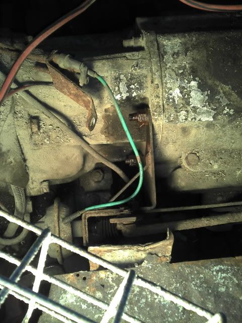

There are 2 bolts that hold the bracket for the vacuum diaphram (?) the round thing that move the rod into and out of 4wd and the 4 hi and low lever............ The nuts on those are rusted, bad, and the nut stays and it just unthreads it out of the t-case. When I noticed a void in the threads it made me a little nervous that there are threads on the other side holding something together inside the t-case.
If I have to, when I take the body off the frame I can just hit it with a cutoff wheel. Here's some pics.
Thanks in advance
Old 01-29-2011, 12:26 PM
I got the Willys....
Posts: 8,702
They don't hold anything together besides the obvious. Pull them out and replace them with bolts, or just thread them back in tight if you can't get the nuts off.
got 'em out no problem. The only thing to note is that they must be a "machined" thread. Not sure if that's the right term but the threads don't start at the end they have a taper then the threads start. No biggie I'll just run to Tacoma Screw on monday when they open and get the right ones.
Thanks again for the help.
