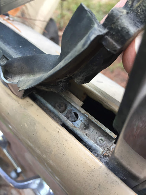

What is the trick removing the vent window from the 79' door? I have removed the window frame from the door but the vent window will not come out..

You need to pull the rubber at the bottom of the vent window to get two one screw holding the vent in place.

rubber pulled back.

The tan door is a 79 model, the primer colored door is a 78. The vent windows are different for 78 and 79, but it looks like they bolt in the same. Good luck.

Thanks FSJ....I never would have found these screws...This should do it
