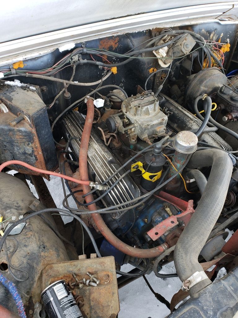

Wouldn't surprise me with how hacked up this truck is. Here's the mess I'm working with.

Possibly from Canada?
Old 02-18-2019, 12:44 PM
Posts: 2,221
Do you have a body lift? That engine looks really low...
Looking at your throttle cable bracket, it looks like it is bent up at the EGR (I didn't think 73 had EGR so that alone may indicate engine swap?). On my 401 when I went from 4bbl to 2bbl (don't ask why, long story), I had to move the bracket and it interfered with the EGR in that same place. That also may be an engine swap indication.
I'm with Wiley-Moe, I bet it was originally a Canadian truck.

I dont recall seeing a body lift, however it's not something I've actively looked for either. I do plan to install one though like I had on my 67. Are there any castings that would help identify what year the motor is?

Unless you have the stock valve covers it won't apply to you but the 360's came with the build code stamped on a metal tag attached to the right valve cover.

Ah yea that is long gone. I'll just have to swap a 4 barrel intake and carb on so it matches my vin Haha. I plan to pull the motor, trans and tcase out this spring to rebuild the trans and tcase and put in new gaskets on the motor. Assuming the compression test is healthy.
