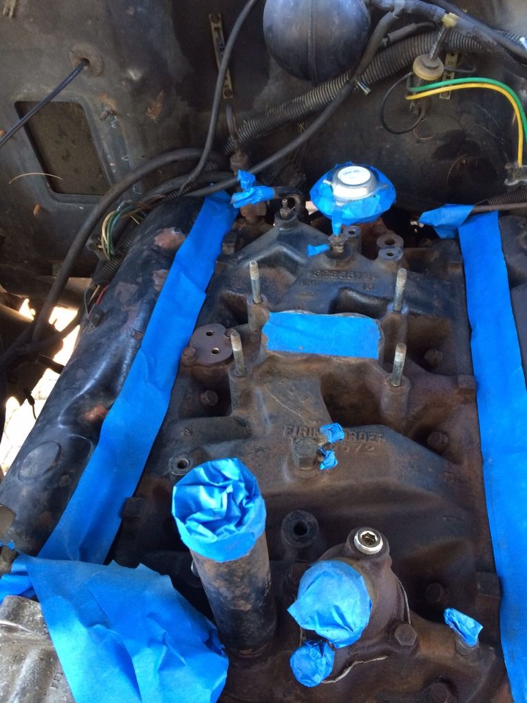

They should be 3/8-18 NPT pipe plugs. I used S/S ones when I plugged mine. You can see one in this pic that I used temporarily while I painted my intake.
