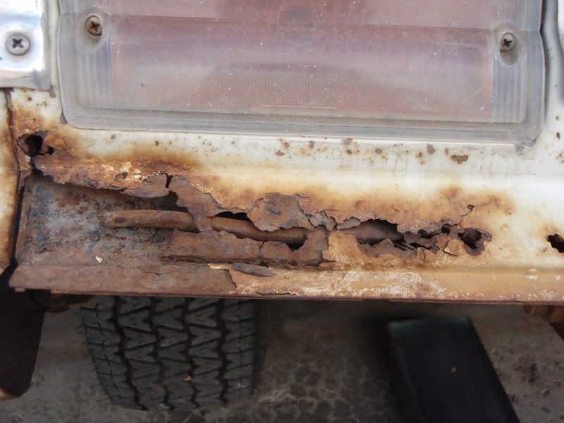

do you see the pliers? i never notised this before, it must have somthing to do with the fact that this is the only rust on the whole truck?
[pic]
Perhaps someone from the factory (back when your truck was built) is missing it? lol

rare jeep pliers
