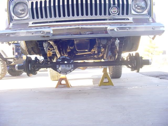

X2. And I did it on my '71 about 3 years before JP did it on their's. And the years are '80-'91. Mine's out of an '85. It's pretty easy as swaps go. I used the tire rod and drag link from a J-10, JP did something different.

Not necessary with the Dodge axle I used. The stock post mount spring spacing places the spring pads wide of the diff housing. Easier to weld on new spring pads than to relocate the springs.
Here's what it looks like with the Dodge axle slung under.
