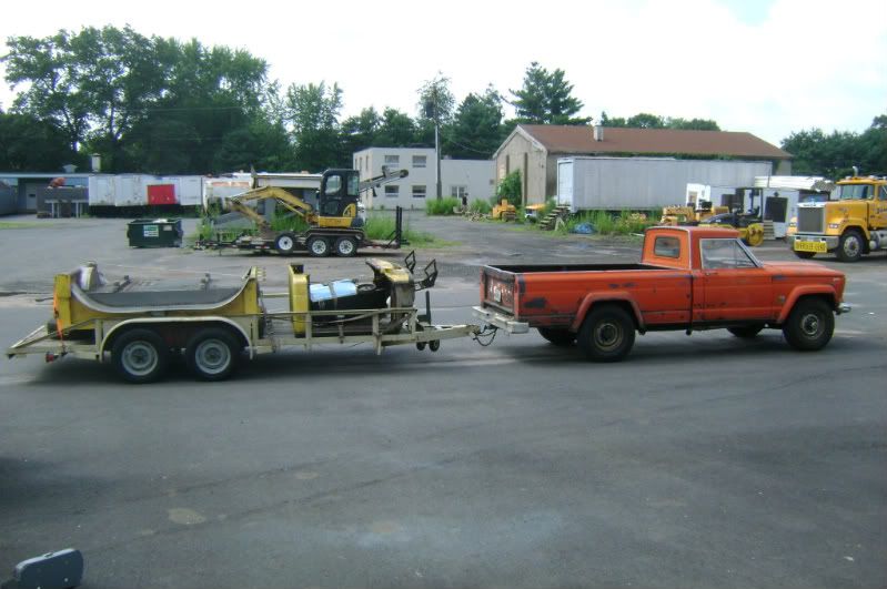

Well, I haven't towed anything really heavy, but judging from the discussions on 4btswaps.com, a 4BT can tow anything, just not at the speeds a larger engine can allow.
If you are going to be doing a lot of heavy towing, a 6BT might be a better option, but if economy is your main concern, a 4 will do fine.
F350s in Brazil are offered with the electronic version of the 4BT...
This is the heaviest I've towed, which is not much.
