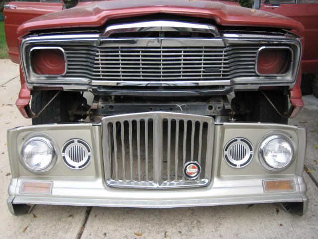

So.. this weekend, I changed directions on my Rhino project. After some welding and grinding on the face panel, I talked my buddy out of this little gem..... I have to return his grill and pie plates, but his face panel does not have the deep wrinkles at the bottom like mine did.
So - face panel changed.. had to cut out the lower portion of the face panel.. seems the 79 frame extensions hit the bottom of the early style face panels.
Funny, just read the great article in Jeep Junkie about changing the grills over. This is one small detail they missed. I suspect the author never installed the grill on a post 3 pc bumper frame. It's a great informational read btw !
Plan to make some "Gap hiders" to address the holes at the top of the grll / hood meeting area. Going to try and use a pc of an old, scrap face panel and graft it into position.
