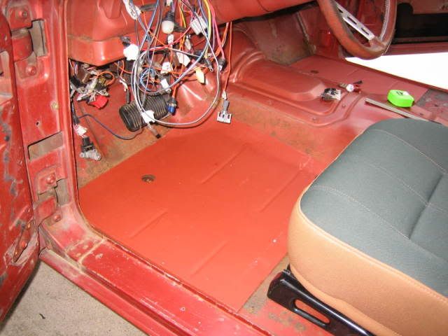

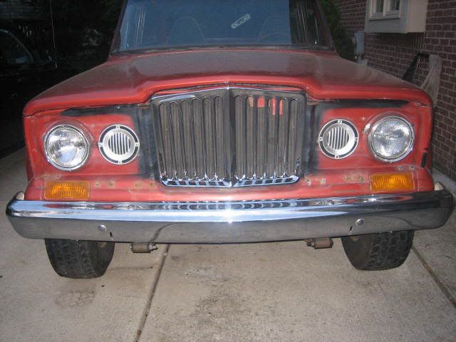

OK - been doing some stuff -
Tried a bunch of various seats.. all seemed to sit too high or would not mate to the stock trac. So, I got a set of 2001 TJ seats.. and cut the trracs down to about the right height. [ Look at the floorpan pic to see cut trac. 3" removed was the majic number btw]Need to adapt the mounting holes yet, but the seats tip foward... pic below
And today I really kicked on the Rhino grill. Hmmm, seems so easy watching it TV ?? I took a long time to get it together. And my welding "skills" are VERY rusty. see pic
And, got my floorpans today from OBX .. I must say, I am very happy with the fit ! That is going to be a job ! But am excited to tackle that next weekend... it is "Labor Day", right ? This is gonna be my labor.
OH, and the Jeep would not start after I powerwashed it. Hmm, figured I got some critical ign part wet. But No ! Turns out, some little rat stole all the gas out of the Jeep in the driveway ! Took me a day to figure that out. Duh. It had maybe 12 gallons in it.. no big deal. At least its running again !
EDIT : I cannot upload the pics ?? I made them very, very, very small. [ 100 x 35 in the end ]And it says it still exceeds the quota? It shows a lot of green in my alloted photo section ? [Edit-seems one can only have so many pics in a single post maybe? Deleted some and got a pic to load ]

http://www.ifsja.org/forums/vb/attac...3&d=1219591941
Is that the stock bumper with no modifications?
Old 08-24-2008, 08:32 PM
cu4whln's Avatar
cu4whln cu4whln is offline
Join Date: May 16, 2008
Location: Canton, Mi USA !
Posts: 1,279
Yes - chromed alum. Not going to hold up well to off road use I suspect ! lol
I am thinking of finding a very good 3 pc. They are steel, right ?

Originally Posted by Knuck
The seats look killer!! I would like to see some detail pics of the seat rails if possible.
Thanks - been a bugger finding the right seats that fit the bill for a 2 door. Am working on welding up the final tracs now. Not pics yet.
Here's what I wrote about the seats in another post, I copied it over to this post- read on
__________________________________________________ _____
I am putting TJ seats in mine.. [2001]
The pass side is the problem.. dam wide tunnel !
So, I am using the TJ tracs, but cut down 3"... this gets you at the stock ride height for the seating position. Make sure to maintain the seat cusion angle when doing this. Also, a "Tip-N-Slide" unit would not work well due to the pivot mechanisim is in the area that needs to be cut off.
So, I am using manual driver tracs on BOTH sides..... the seat backs tip forward, and the pass seat has a nice pull tab on the front leading edge of the seat back. This lets you pull the seat foward.. there is a button on the lower seat backs as well - if you are in the back seat.
Now, the tracs are offset.... kinda like our FSJs.. but the pass side should really be inboard a bit.... if not, the armrest is too close to the seat and uncomfortable.
So out comes the hammer... I flattened the floor at the front of the tunnel area to let the trac sit in farther. The mounting holes do not line up. I will be welding a flat pc on the bottom of the trac to reach the holes.
Driver side is really no problem. Will have to adapt the mouting holes to the TJ track.
Now, the pass side has a cable that used to "trip" the Tip-N-Slide TJ trac. I think I can make a bracket that will pull the manual trac to the release position. The cable is tied to the seat back.. when it tips foward, it pulls the cable.
So what you ask ? Well, if I can get that to release the trac, I have a seat trac that will release when I tip the pass seat foward to get in the back.. How cool is that ! I am in mid project right now.. but will share when it's all done....

Tonight I tacked the tracs together while on the seat... they are seperate, but I want them off the seat so I can make the mounting brackets to the floor.
One pic is of the cut down TJ trac on the floor - with the 2 tracs tacked together. Now need to make up the floor brackets to pick up 3 of the original 4 holes.
Notice, I "adjusted" [ aka moved with a hammer ] the tunnel on the pass side. This is to get the seat inboard enough to make the armrest comfortable.
