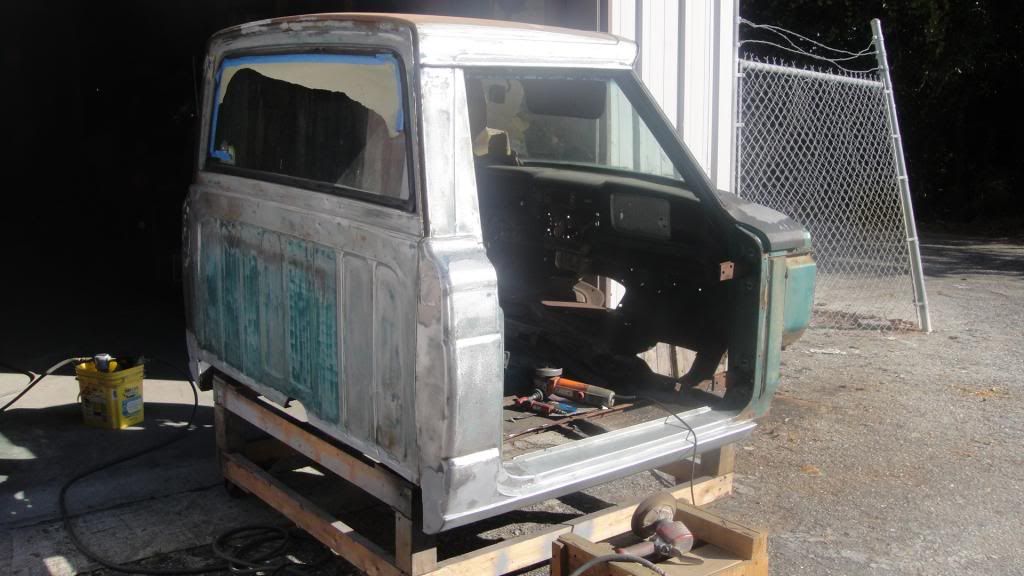

More rust fixing. cut out, weld in, lead it, then body fill...
This trim has an unexpected, nasty suprise behind it-more rust

Wow, that's some pretty hardcore rust. Your bodywork skills are better than mine. When I started seeing that level of rust on my cab I bought a donor truck for its rust-free sheetmetal, sold off the mechanicals, recovered all my money, and went from there.
Congrats on sticking with it.

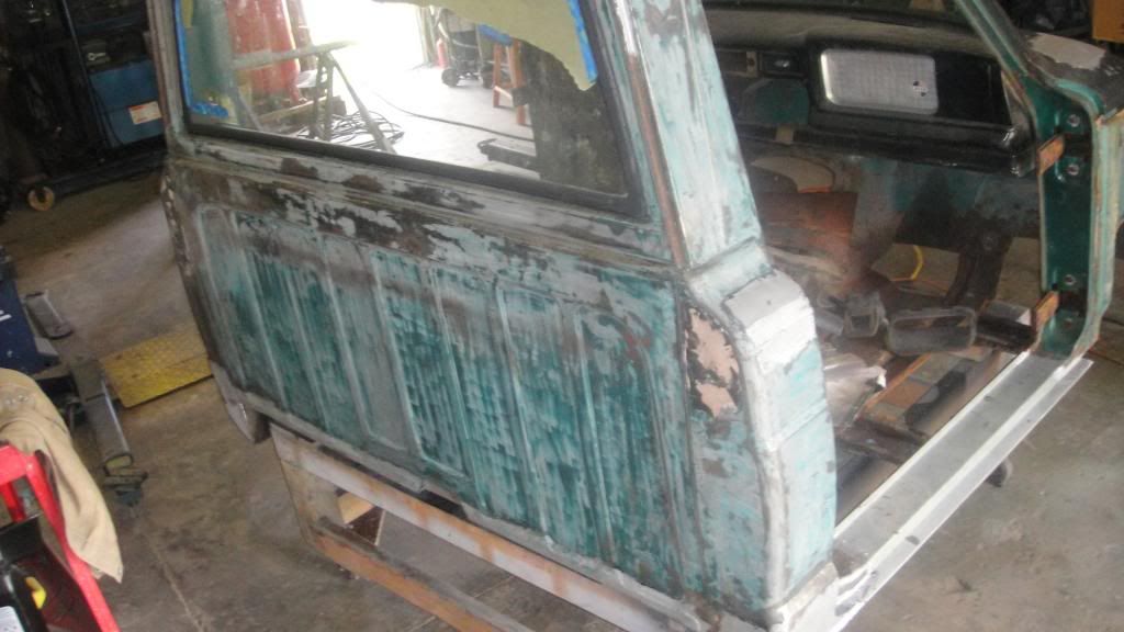

Stripping time...I keep telling myself It looks farther along than it really is since the floor still has to be addressed when we get the frame over to our shop But good progress none the less

I just realized you mentioned, "lead it", up in post #61.
Are you referring to melting lead similiar to soldering, as a filler?
The reason I ask is because I've only seen it done one time and it struck me as a better way to fill, over using a "bondo" type filler. At least for smaller areas.
I know there's some health precautions that need to be taken, but besides that, is it pretty easy to do. I was considering it for some areas of my truck.

That is correct, this is the first time weve used it. Our thought (probably yours too) is that because bondo and most fillers are porous moisture can get down to bare metal. You should also be able to build it up more w/o issue. We also usually use a product called Allmetal for filler before a "thin" skim coat of bondo.
The body work has been my dad so far since ive been up at school/work. But ive watched him try leading a corner. We bought the kit from eastwood i believe. He said he watched a lot of youtube vids on it before doing it. The key is to keep the lead puddle barely liquid, too hot and it just runs off.

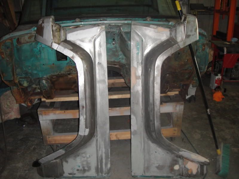

Few more: Primers on, My dads piecing together the front fenders, the inner fenders (and as i said the cab floor) wont be touched until the frame/drivetrain are there to see what needs to be done.

Fenders are done, my dad will be wroking on the grille this week...I will be done with this semester of school by friday, so i'll be driving the ram over to a friends house to begin to swap the drivetrain over to the shortened frame. Im hoping in about two weeks the chassis will be at our shop, test fitting to body to see if anything needs to be modified to fit.

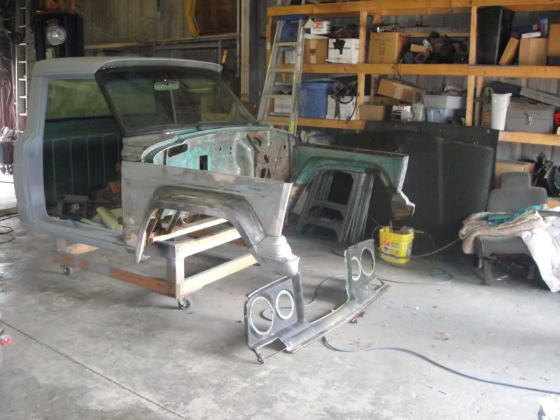

Last bit of rust being taken care of, just have the floors to do and shave the firewall...and make the bed from scratch of coarse haha.

This holiday weekend i got a chance to shave most of the firewall (missing 3 holes still) and weld together an aluminum box to house the stok Ram instrument panel in the kaisers dash.
I was planning on using the Rams stock indash a/c unit, but its just too wide. The new plan is to use the evaporator and heater core in an aluminum box ill make (mostly because id rather weld a box together instead of spending $200 on a new plastic piece).
