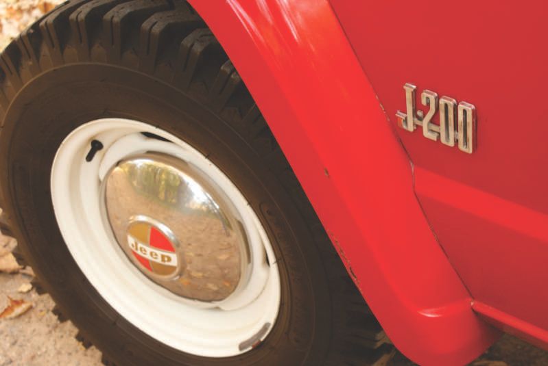

I have Power King Super Tractions on my '63 J200.
I bought them new in 2000 and have put about 14,000 miles on them since.
I bought them for their look more than anything else.
Being bias ply and hard rubber compound, they flat spot overnight. The tread pattern is LOUD on the road! The sidewalls are crazy stiff, so they don't handle well. And did I mention they're LOUD?
Being tall and narrow, they're also great diggers - when you're driving in soft mud or snow, these things will try to find the bottom of it. And if there is no bottom - you'll get stuck.
I LOVE they way they look on a vintage truck, but in all honesty, they're miserable to drive on.
